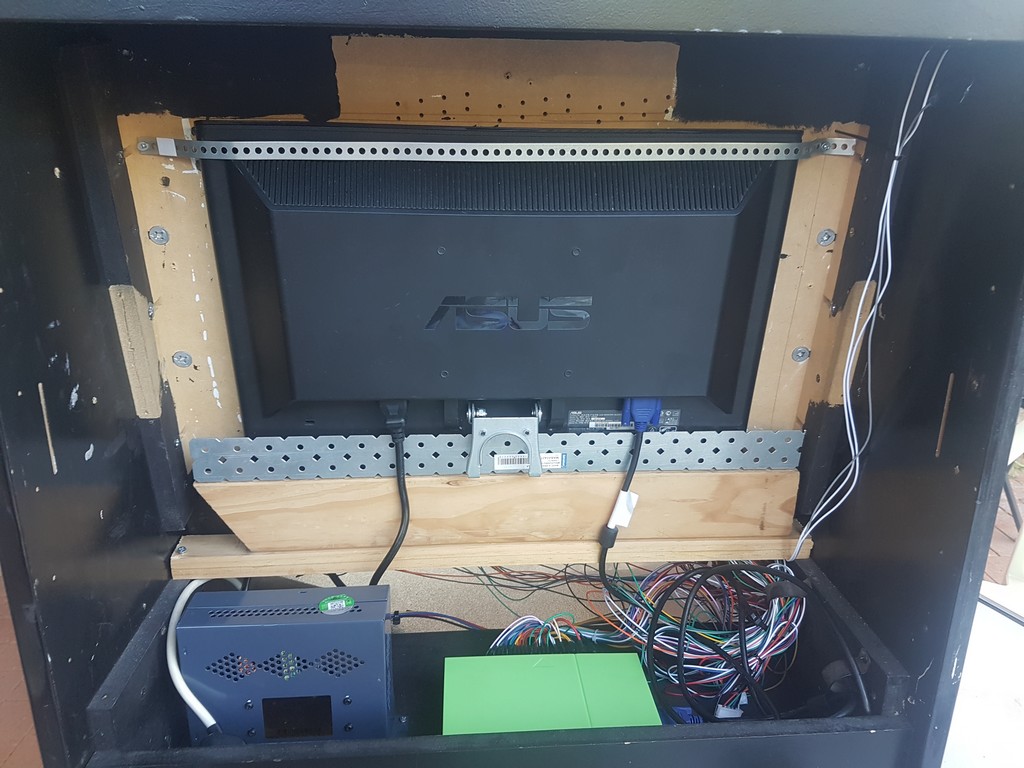

I bought this ArcadeWorx cab of @namastepat back in February. It's surprisingly large, taking up a lot of space on my garage floor so time to get it working and sitting somewhere else.
https://www.aussiearcade.com/showthread.php/92614-Arcadeworx-Bartop-cabinet-with-19-inch-monitor-75?highlight=bartop
Cabs is a little banged up with a few nicks but over all pretty good.
All black and I love the Space Invaders cut-outs in the marquee area.
So I thought I'd continue with the Space Invaders theme and keep the cab Black and Red. It didn't hurt that I had a pack of both red and black buttons 😉 I'd also bought a power supply and jamma harness to match the Pandora 4S I bought back in April.
I installed the buttons and joysticks. Will need to check the controls for the Pandora to see if I need the other 3 holes. I'll use what I need and try to find some of those caps to cover any not used. Also the top row holes are smaller than the player button holes 😞
The P1 and P2 buttons I used (STD size) will never come out again LOL!

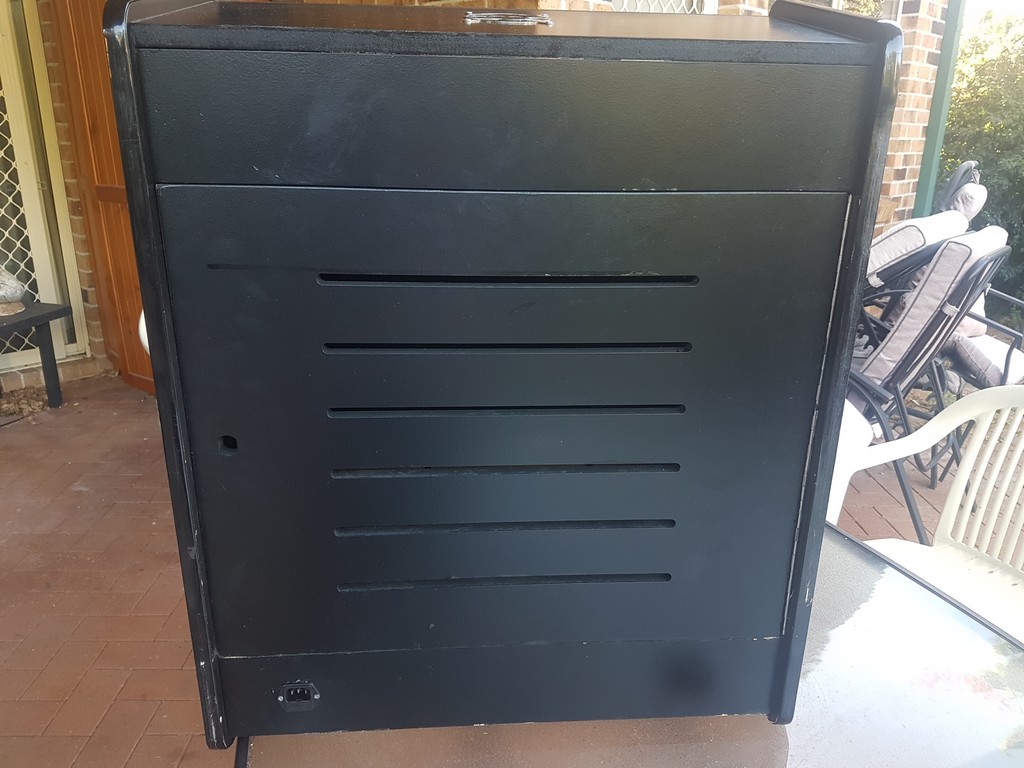

Installed speakers inside the audio cut-outs.
The IEC socket I have is not round like the hole that had been cut out 😞
Traced around and then did a little free-styling with my jigsaw. The flange on the socket hides the shoddiness 😄
Wired mains socket, power supply and jamma harness power. I then fired it up to see if smoke would come out. Success!
Damn I love how fast these Pandora's boot up unlike those shitty 60-1 jobs.
It was getting late so I'll finish wiring in the joysticks and buttons next weekend. One last thing was to mount the fan cover into the top. The Alien one I had suits the theme.
With the top cut-out I've love to put in some acrylic and then an LED strip that swipes from left to right. Not sure how I'd do that but lit up red and sliding across would be awesome.
I also need to source some black t-molding as the control panel strip is missing.
I am bummed its a widescreen monitor but the bezel was cut to match and the screen came with it so I can't complain.

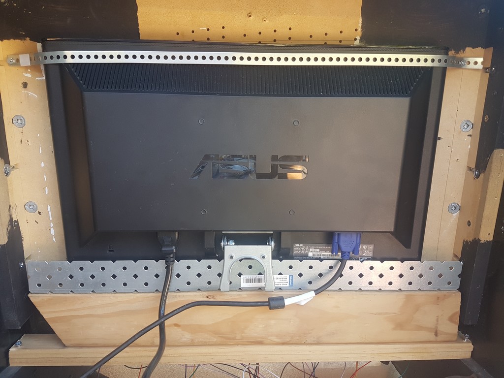

I've just finished wiring up the cab, mounting the monitor, PSU and Cart. Just some tidy ups, mount the door then I can add this unit. It's going to look fantastic! Thanks again mate
Brad
  • Administrators
Update:
Finished connecting up the jamma harness to all of the player controls. I then mounted the monitor. I created a bottom rail and attached a piece of angle the hold the monitor in place. I then used some metal strapping to hold the top in place. Easily removed with a screw in each corner.
I then fixed the PSU and Pandora into the base, tidied the harness with cable ties and used brackets to attach to side. Actually took this photo before tidying and mounting harness

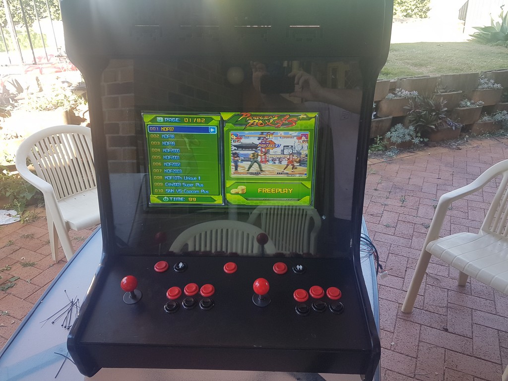

Here is is all fired up. The Pandora has a couple of annoyances though. The games list are not sorted alphabetically and you have sequels pages before original etc. Also they included Ms Pacman but it scaled to the widescreen and plays super fast. No doubt there are others so I disabled that game. A bit of reading and it seems it may be an SD card running xmame so I might take it apart, image it and see if I can tweak it somewhat. Others games that I've looked at run really well.
I definitely would not put a 60-1 or one of these in a full cab. PC all the way imo. They're just handy for small spaces.

      I spent some time wiring up a new power supply, jamma harness and 60-1 board. I decided to use the 60-1 as this cab was a vertical cab and the bezel and monitor shroud were being re-used.
      I'm a real weenie when it comes to electricity so was concerned about wiring mains 240 power to the arcade power supply but 2 youtube video instructions later and I re-wired a std power plug into the arcade power supply within 5 mins. Hooked up the jamma harness to 5volt, 12volt and ground points on it and test-fired the arrangement. The power supply, board and monitor all turned on, the board initialised and after the 60 second startup (why so damn long?) I had the iCade menu displaying and running.
      I tidied up all the wiring and used cable ties to neaten it all up. It always surprised me how much room there is in an arcade cab. Really the monitor takes up most of the room.
      I've gone with an LCD as it's the easiest for me to mount although I do have several spare 19" crt PC monitors hanging around if I feel the need to change it to a CRT look.
      I ended up modifying the monitor frame to accommodate the LCD. I also created a new internal bezel to suit using 3 ply and sprayed it black to blend it.
      Once bolted together the monitor sits nice and flush to the front door.

      The back of the cab also had a large square cut-out that gave access to the old monitor yoke but there was no cover. I bought a grill piece, sprayed it black and mounted it. It looks pretty good.
      Front View minus exterior Bezel
      Now with bezel minus instruction card until I can get it printed.
