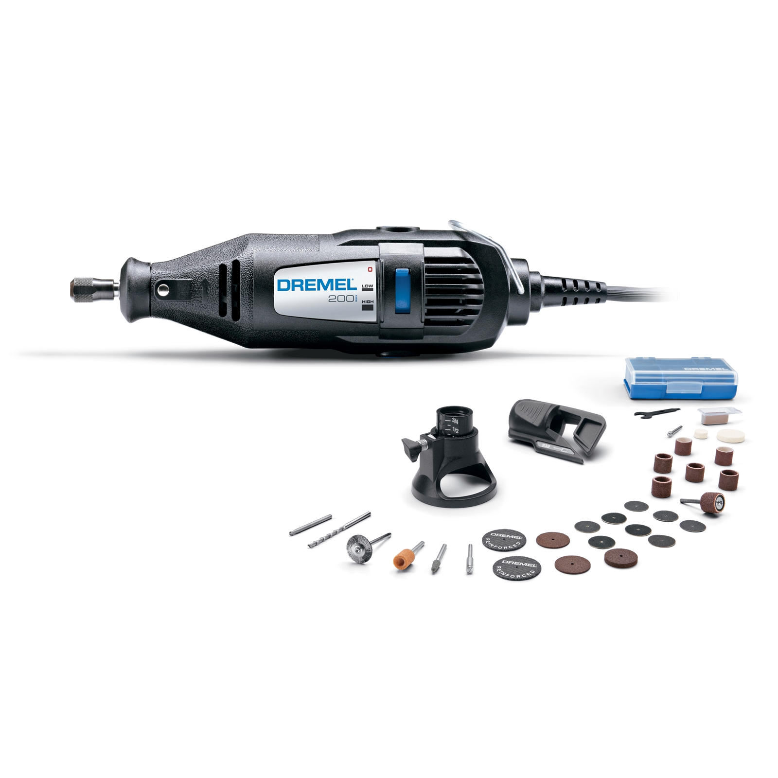

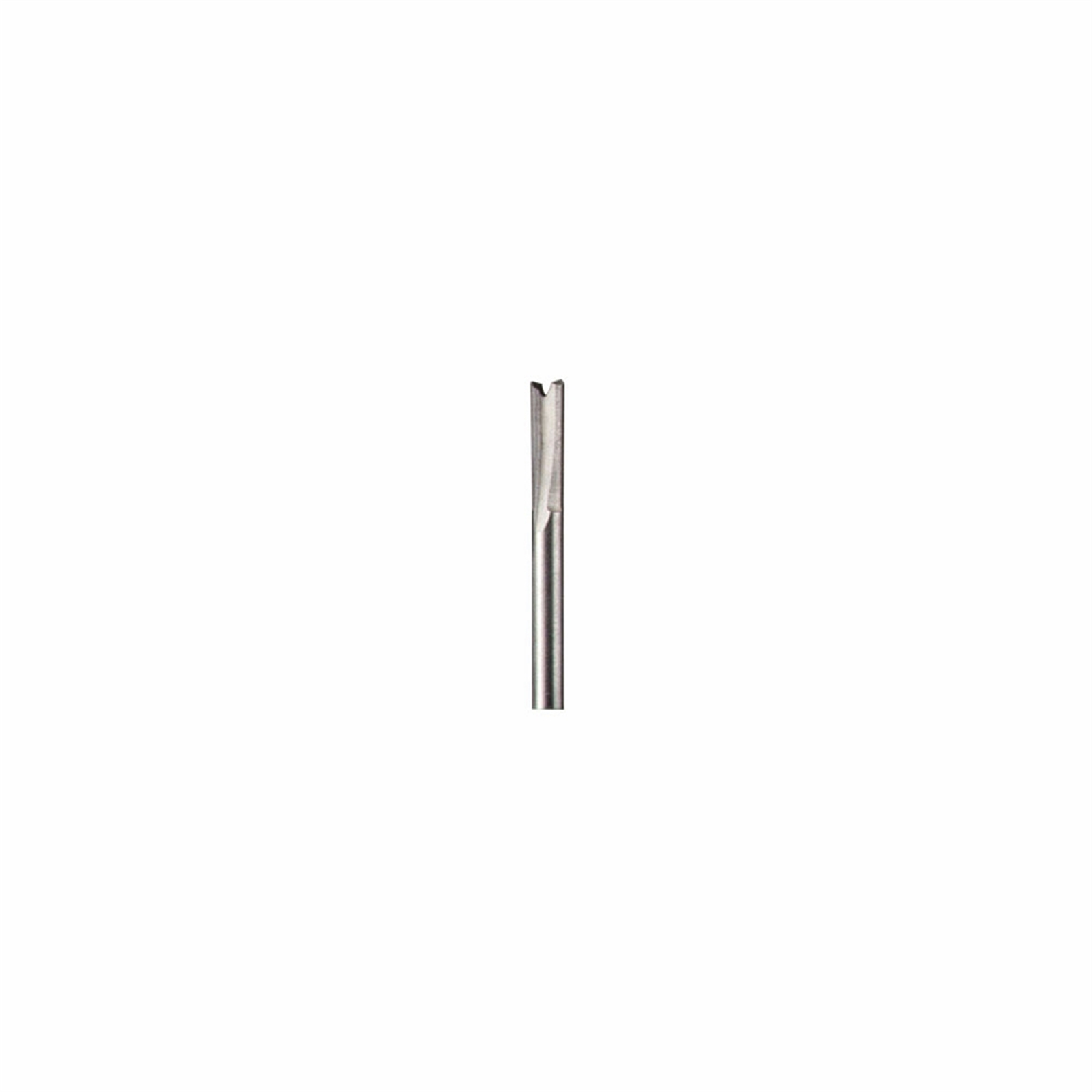

Well Santa has me sorted for insert holes I think...
One of these...
One of these...
And a couple of these but assorted sizes...
I'll take the time to make some suitable metal insert guides to aid the router tips rather than trying to route out the inserts freehand as I think the time it takes to make the guides will save in the long run.
