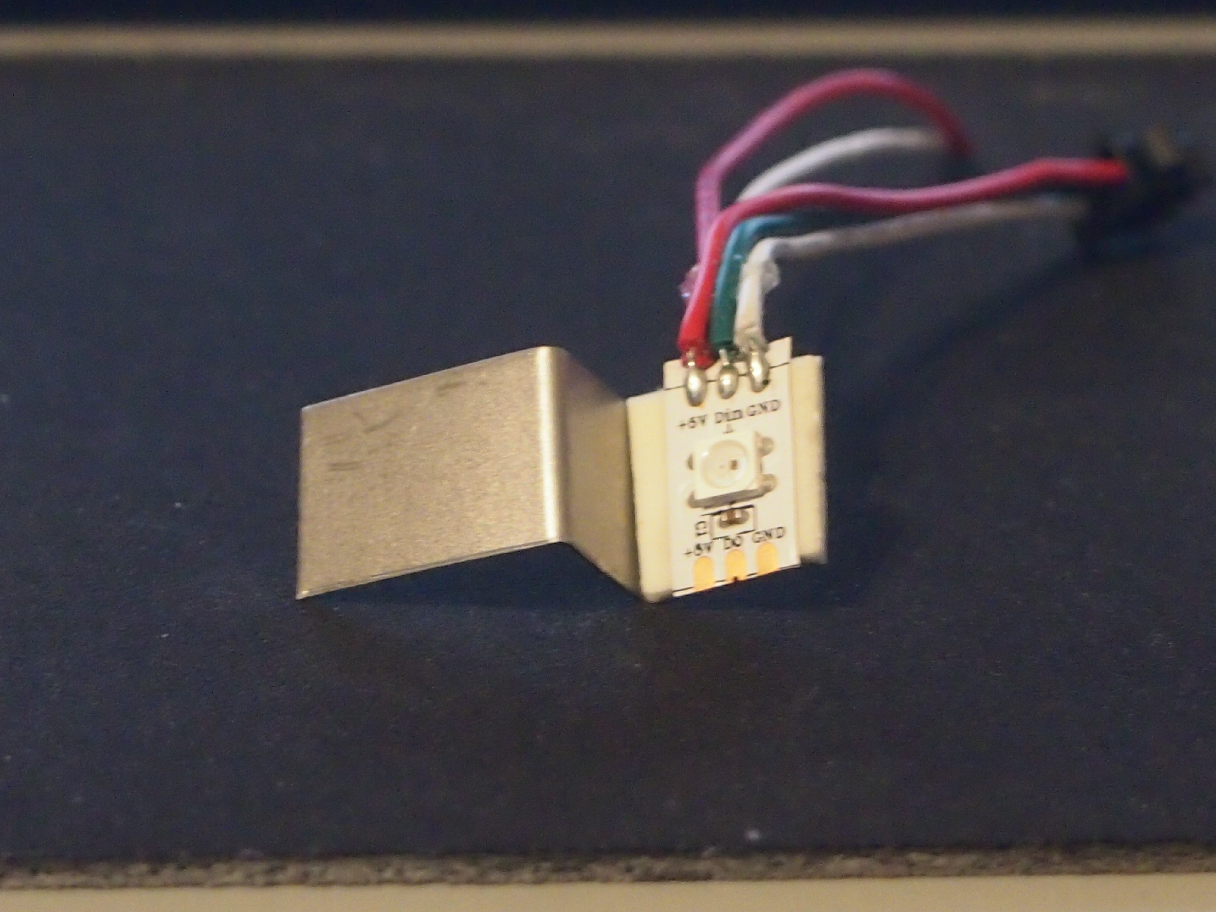

I've figured out how to use FastLED to handle all the LEDs so I can use them in a single string of 37 for the playfield. This will help greatly as it will reduce the number of pins required for running the LEDs on the playfield to a single pin on the Arduino Mega.
leds[0] = CRGB::Blue;
leds[1] = CRGB::Green;
leds[2] = CRGB::Yellow;
leds[3] = CRGB::OrangeRed;
leds[4] = CRGB::Red;
leds[5] = CRGB::DarkMagenta;
FastLED.show();
It keeps track of the LED string colors by position. Initialize all the LEDs to the color you want then simply use the LED number in the leds[x] command to choose the LED and set the color using an RGB string or using the CRGB::color_name to do it by friendly color names. Once the particular LED is set, use FastLED.show() to write the string out with the changes desired.
As for mounting the LEDs... Dallas Makerspace had a 12" metal shear and I used it to cut down a 12 x 24" sheet of 22ga steel into strips. While at DMS one of the members helped me cut a slot in the 18" metal brake I bought at Harbor Freight Tools. This allowed me to be able to bend the strips into a Z shape and I used a set of hand held metal shears to cut the strips to size. A quick application of good quality double sided foam tape holds the LED in place.
Now I have to cut out and bend 36 more for the other playfield LEDs. :)
