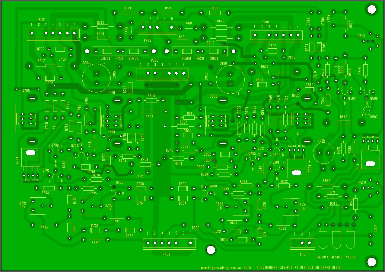

Today I finished the assembly of the Chassis
I hooked it up and nothing blew up.
But I have no space to work. I barely could make my way behind the machine. I need more room to work safely
I have the machine playing blind, and I had some HV. I used my HV probe to discharge to monitor and the chassis had HV, it was already dropping and was at about 4KV when I hooked up the probe
Like I say, it's progress
I will make some room in there and test my voltages and see what's going on. I have to set the B+ to 115V etc. I may fit a new anode cup on the HV lead. The original one is a bit hardened so risks falling off during the test
More soon

If you ever make your one up mate, good luck. There are so many shortcomings. I will prob redo it, when I do the G05-801 defl soon - Same batch
Will do . .
That's ok, I'll get to it one day. Did I read that right, you're doing the 801 deflection pcb?

For the 801? Maybe
I started the Reg board, but the heatsink is not available
The HV board . . . The LOPT is not available.
All I can say is never say never.
It took me 3 or 4 days to complete the 801 deflection. My first one took 4 weeks. So I may do them, maybe all of them?? Hmm we'll see

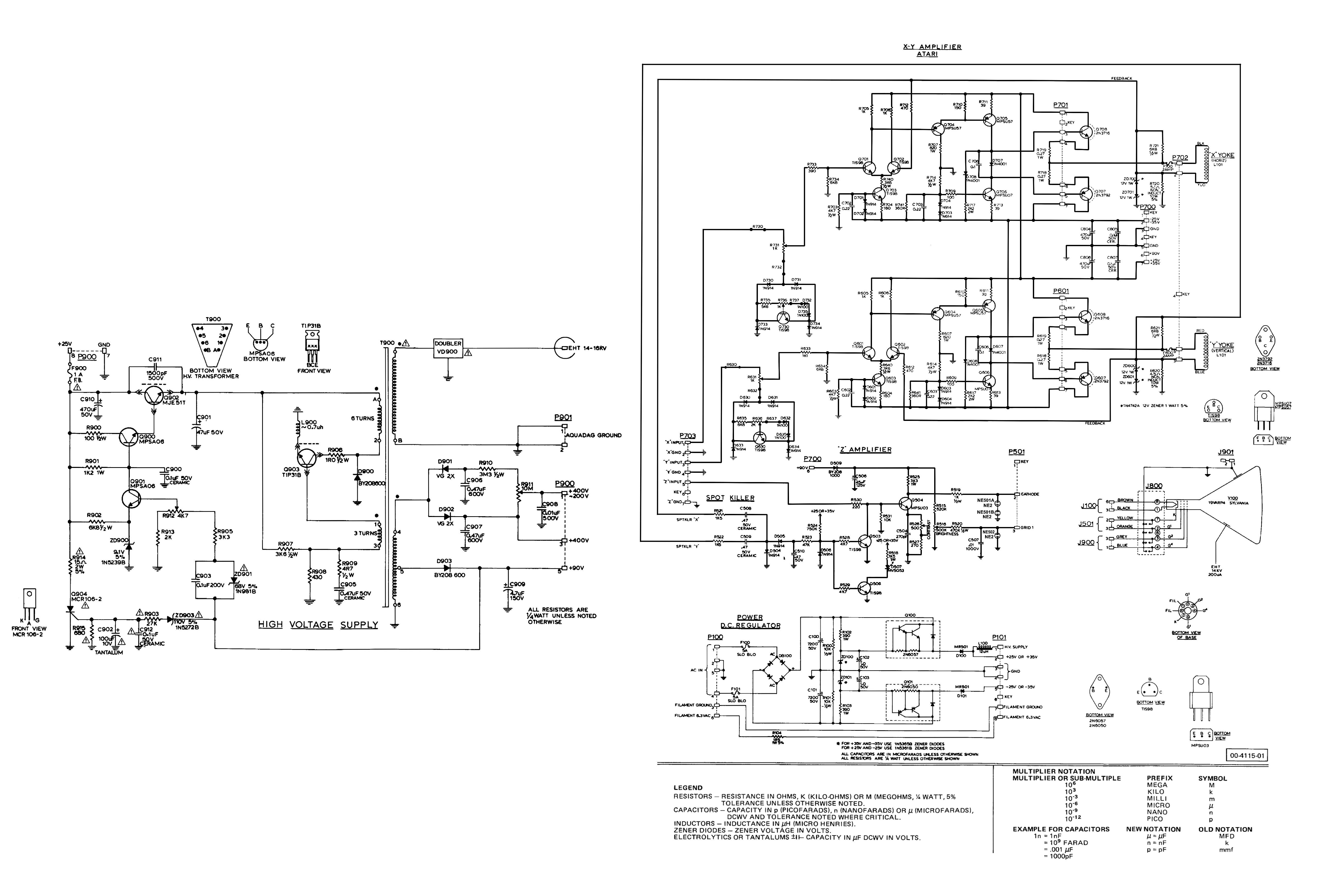

I bought up a box of B&W LOPTs from a Wyse Monitor, as the schematics looked similar, when they arrived I tried to reverse engineer, using one of them as a Guinea pig. But there was a join between windings which didn't belong, and it was too hard to cut the join
They were cheap, but no good. Que Sera etc
Maybe you can make one ourselves
Look at this diagram, the number of turns is printed on the diagram's LOPT
http://www.amazingarcading.com.au/G05-801_Schematic_2015-sm.jpg
- - - Updated - - -
The doubler can be made, someone documented that a few years ago
See here
http://www.arcadesolution.com/blooming.html
- - - Updated - - -
The diagram above is from an 801 by the way

Hmm... would make an interesting project. At least you have the mystery can sorted.
