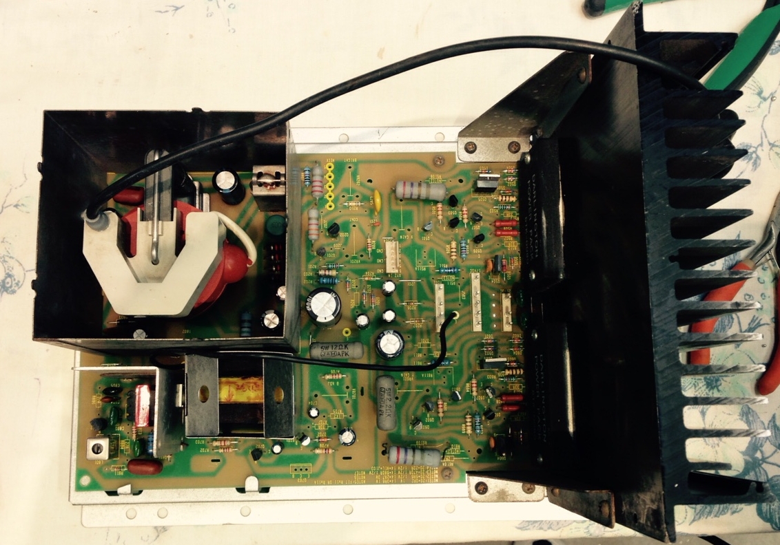

Today I spent 30 mins and started to assemble my prototype
Here's some pics so far.
Just spending small amounts of time on this here and there (a time consumer) as other projects are finished too

I picked up 4 or 5 chassis in this kind of condition, and am restoring this one first (One or 2 are worse)
http://www.dsbelec.iinet.net.au/LAI_KZ-002-sm.jpg
Flyback on
http://www.dsbelec.iinet.net.au/LAI_KZ-004-sm.jpg
Heatsinks and shields on
http://www.dsbelec.iinet.net.au/LAI_KZ-003-sm.jpg
More to follow . . . I bought all the parts years ago, so I have to track them down in my shed. (I cleaned the shed a few weeks ago, so there is hope . .

Well, this is more than 3 years in the making since I started, but time is precious. Life gets in the way
Here is the progress I made today towards making my trashed battlezone game a reality
http://www.dsbelec.iinet.net.au/LAI_KZ-progress-sm.jpg
The parts Mike send me years ago are finally getting fitted. Thanks again
This PCB has a few errors - Oops. It was early days, and a prototype.
I completely forgot to mark a few caps (No cap screen print at all, LOL), and made spacing a little too big on other caps
Some of the parts are left off my list too, so there will be updating to do
I can say, I seriously doubt I will ever do another run of this PCB again, so John and I will have the only 5 made.
I look forward to the day I can turn this on and get a picture (I hope)

This is getting close now
I have more parts to order, and a few to figure out (Inductors/caps etc)
Note to John: The pinouts for the transistors are correct but the image orientation (Transistor picture on the board) is not.
This type of trannie
http://www.dsbelec.iinet.net.au/GE3TO92-40.jpg
Unfortunately I didn't know that most old pinouts are available in 3 types. Most were ECB, some older alternatives are CBE, and modern alternatives are EBC
When the boards were done years ago, all were done as modern EBC, so none line up with original items. If you look at the pic below, all the transistors are on a 45 degree angle (LOL)
Also, there are tons of typos, and omitted IDs, and some bits too close to others. Oh well, if it works I am fine with this

This is the hardest board to assemble yet. It's all in 1, it's tight, it's poorly marked (By me) LOL
The parts are obsolete, and some were ordered 3 years ago - so buried in the shed. Ahhh
The original diagram is illegible, the re-drawn one is imperfect, I have found. At least I can fix it now
Still making progress.
Fitted more parts today, here's the pic
