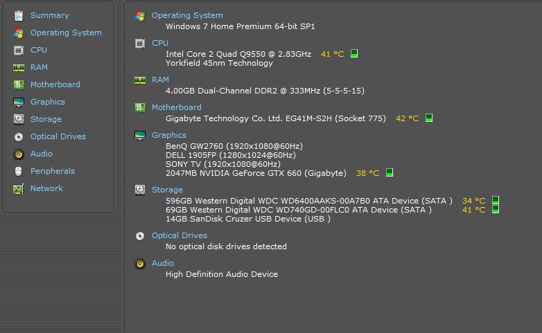

    I remember @OzStick used to have a thread about specs he's tried with VP10, I couldn't find it, but thought I'd post this.
    I've been setting up an old desktop I have as a test with VP10, as i wanted to extract the current gaming PC in the VPin and use it elsewhere.
    The old desktop i've been setting up is an older platform i've used as a development and work pc for a while. Speccy dump:
    These components can be had pretty cheaply - the Q9550 CPU is an old but very capable Quad Core CPU ($20-$40 Ebay) and I scored the 2GB 660GTX for $30 as the only bidder on fleabay. The HDD's are nothing special at all, no SSD, and only 4GB DDR2 Ram.
    This spec is running VP10 full screen with two screens perfectly, Max detail settings, realtime AO updated, reflections on playfield, 1080p res playfield and 720p backglass. Ran ACDC perfect, and I tested some of the more recent releases from the last couple months, all run perfect.
    Pretty gobsmacked!

        Nope - a Core2Duo will struggle trying to run VPX even with all its settings cranked right down. You'd end up with tables that don't look that great due to losing too much detail and the performance still won't quite be up to the task.
        You are way better off spending a bit more on something like this:
        HP Compaq PRO 6300 SFF, i5 3470, 1 GB dedicated graphics, Win 10 Pro for sale online | eBay
        That PC is still very good value for money and combined with a GTX1050 and a 240Gb SSD it will run VPX really well. There will still be the odd table here and there that will struggle, but for those you can slightly lower/reduce/disable certain settings on a per table basis to get them to behave.

              you only need the one card to run 2 monitors, as long as the card is good enough. I've run 2 monitor setups on a 660 and a 970. the 970 was overkill though.
              i haven't done exhaustive tests with the 660, but it run everything i threw at it including complex sterns like ACDC. and i got the 660 for $30 bucks !
              the machine ozstick linked is a bigger case than the optiplex, so it should fit most cards. i had to pull out the tin snips to shoehorn the 970 into a standard (older) PC tower case though.
              newer cards like the 1050 would be smaller form factor i'm guessing. (haven't seen one in the flesh to say for sure.)

                      wasn't suggesting get a 660 gtx... just that i got one for 30 bucks and it's running vp10 well in an old repurposed desktop i already had.
                      if doing a new build then sure, get a 10 series card the power and noise factors are both much less.
                      those links above look like a pretty good build to get going with vp10.
                        #12
                        The i5-2400 will slow things down somewhat and affect performance in VPX to the point where you will need to tweak some settings (probably) further than you would want to.
                        The minimum spec I've been suggesting lately is an i5-3470 and you should be able to pick up an HP/Compaq, Lenovo or Dell SFF for around $175 with that CPU in it. The video card and SSD you've linked will be perfect - IMO 240Gb is fine for SSD but the 500Gb will give you plenty of overhead should you chose to use PuP Packs or go crazy with high quality media files for all your tables.
