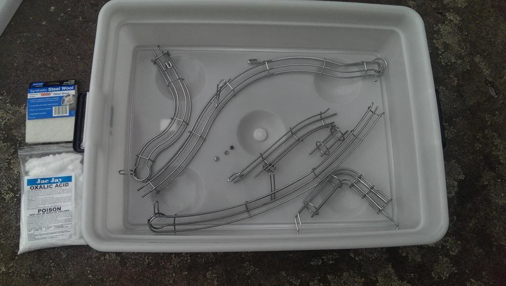

    Here are the things you are going to need:
    1 x large plastic bin. I use the large 'under bed' one available from Bunnings. I think it was $23.99. It fits 4 Bally/Williams legs. It won't fit Stern.
    1 x bag of Oxalic Acid. This was also from Bunnings and was $17 (see below for pic). This is what you use as a Timber Bleach. Google it.
    Rubber gloves. Heavy duty ones like dishwashing gloves.
    1 x 3m 000 Grade Pad. This is a Non Scratch pad (see below for pic)
    An old toothbrush. You'll need this because some real stubborn rust will go yellow and that stuff it usually in the joins.

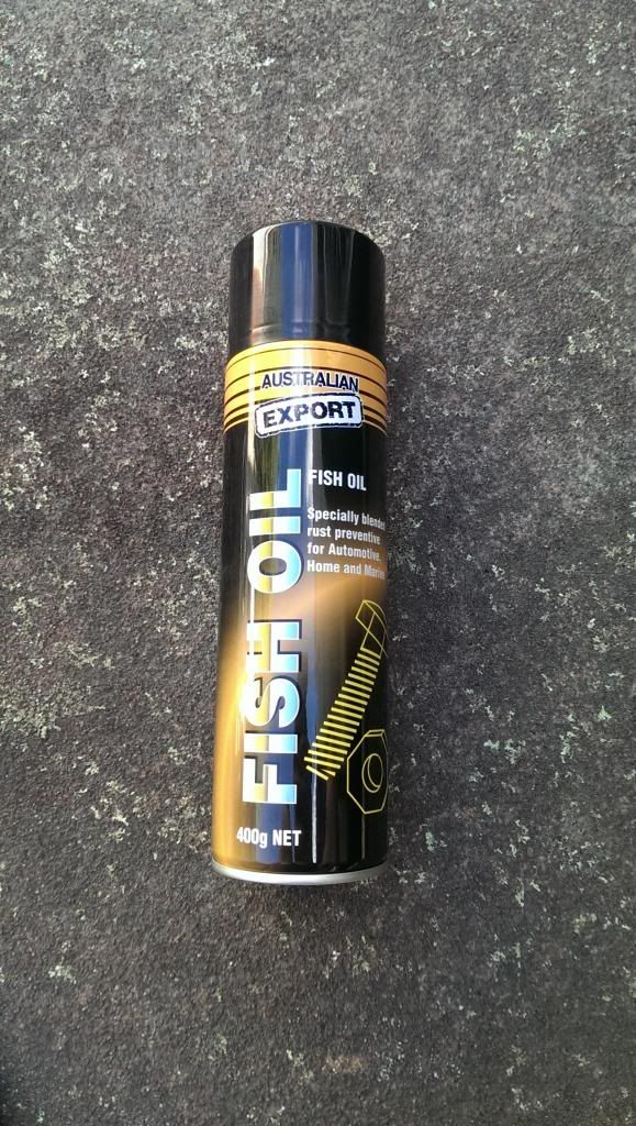

    Fish Oil Spray (or any other rust inhibitor).

    Put on your rubber gloves and then put 1 heaped tablespoon of the Oxalic Acid in to the bin and fill with water. Give it a quick stir with a stick.
    Gently put in the chrome parts you want to clean. Careful not to splash! Now put the lid on the tub and wait.
    http://s936.photobucket.com/user/spacies/media/2014-03-09125804_zps0346d7d0.jpg.html][/URL]
    That's it! No need to sit there for hours swearing and cursing scrubbing those wireforms. The minimum is about 6 hours but it is better to leave stuff overnight.
    With the real stubborn rust, you'll need to hose them down and then repeat the soaking and maybe add another spoon of Acid. You'll see the real stubborn stuff because it will go yellow.

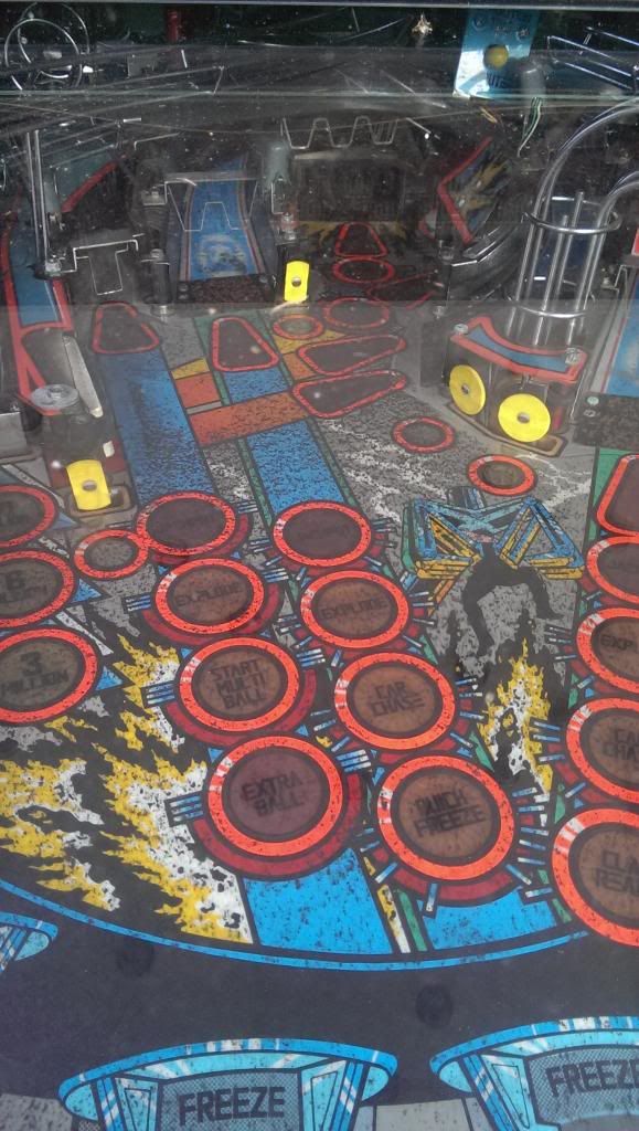

    Righto, I purchased the world's dirtiest Demo Man:
    http://s936.photobucket.com/user/spacies/media/2014-02-20122014_zps7d12d23b.jpg.html][/URL]
    This sucker was just filthy. All that black stuff is the perished rubbers from the playfield which has been picked up by the balls and deposited everywhere! There were rubber bands on the outlanes that had perished and melted on to the playfield. Eek.

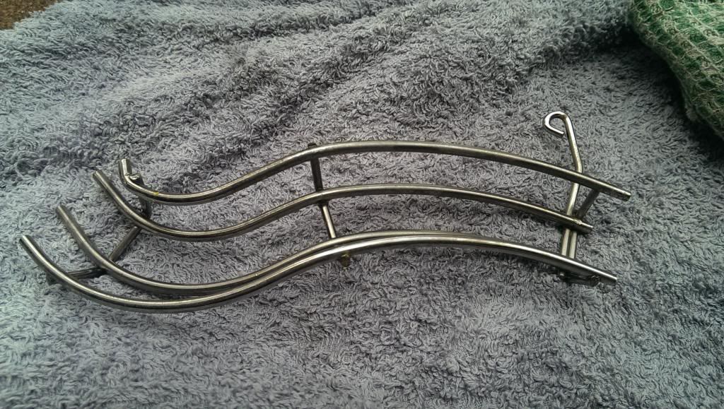

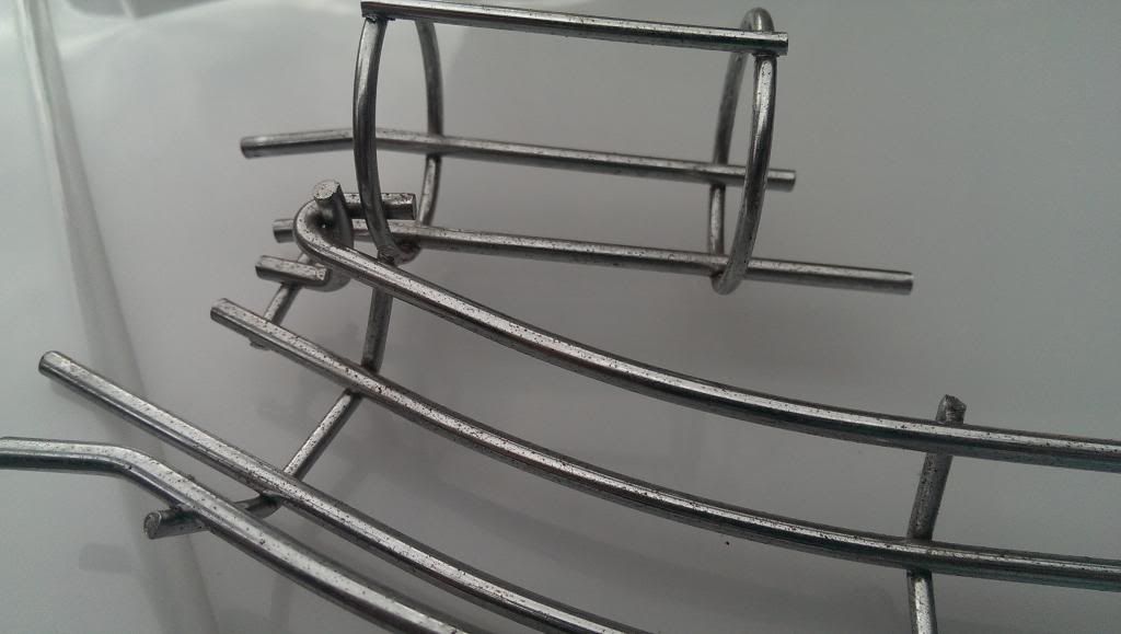

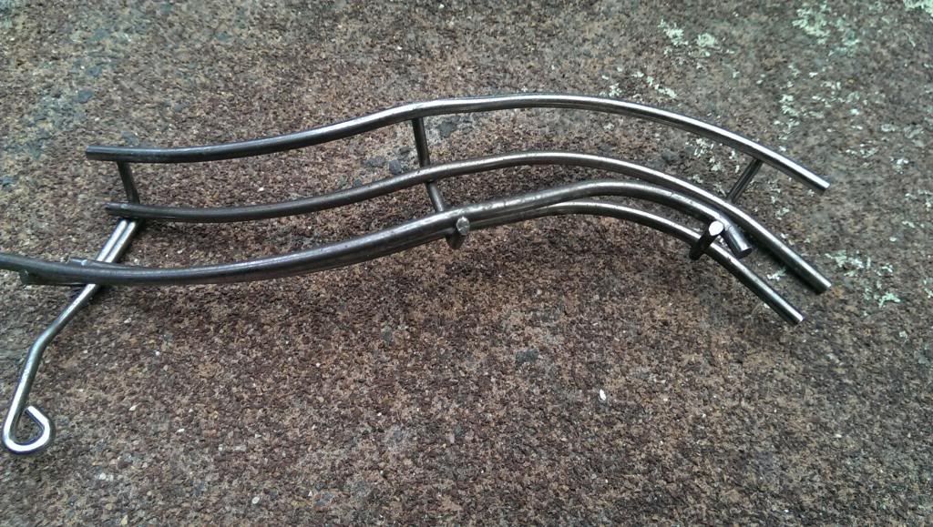

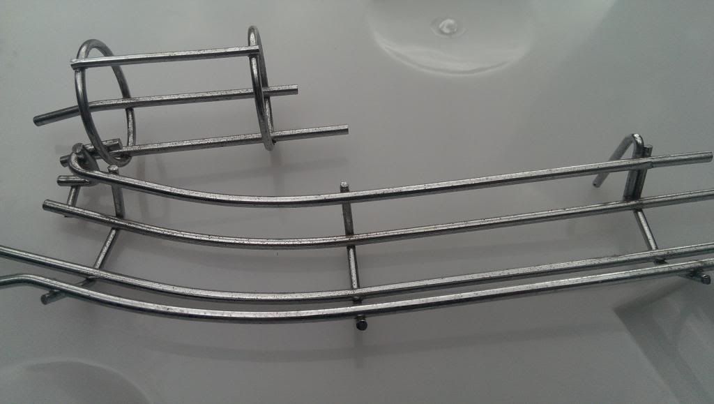

    So the wireforms looked like this:
    http://s936.photobucket.com/user/spacies/media/2014-03-09125830_zps6d1ae638.jpg.html][/URL]
    http://s936.photobucket.com/user/spacies/media/2014-03-09125907_zps82558ccd.jpg.html][/URL]
    http://s936.photobucket.com/user/spacies/media/2014-03-10190213_zpsc70fda52.jpg.html][/URL]
    http://s936.photobucket.com/user/spacies/media/2014-03-11170226_zps3c3a67c0.jpg.html][/URL]
    All of them were like this, dirty and with thousands of little rust spots. I have been down the rub 'n scrub route with these things and it ain't fun, but you already know that. My first encounter was TFTC which also has a lot of wire! I spent a whole day rubbing those damn things until I was over it. Arggh.

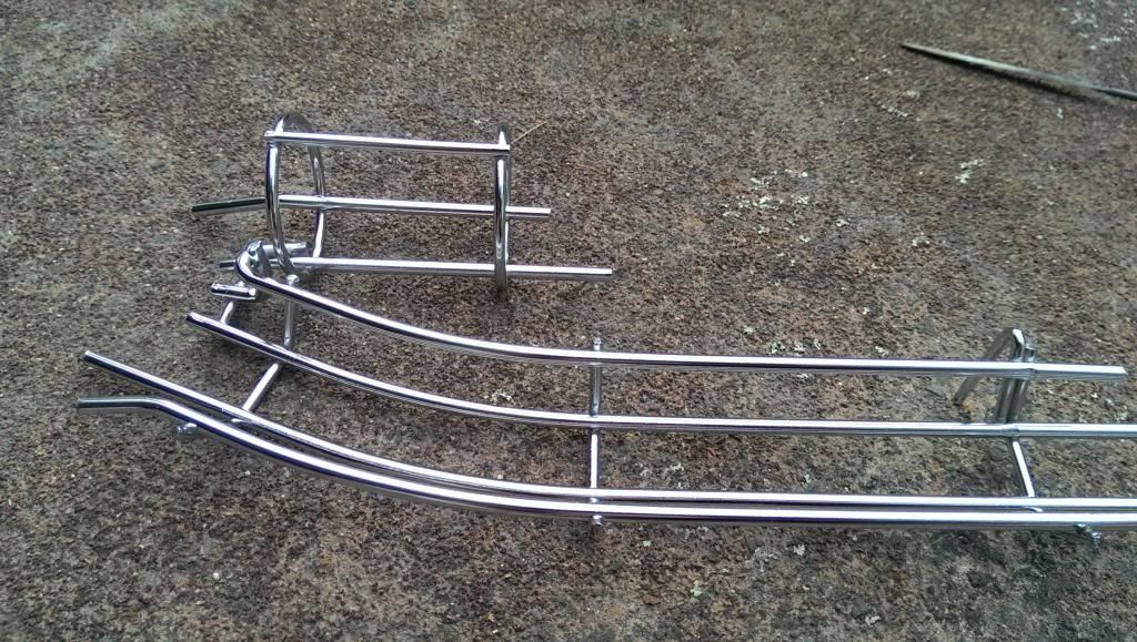

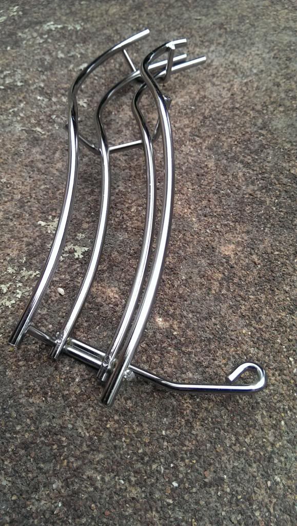

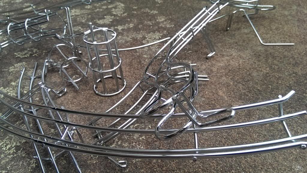

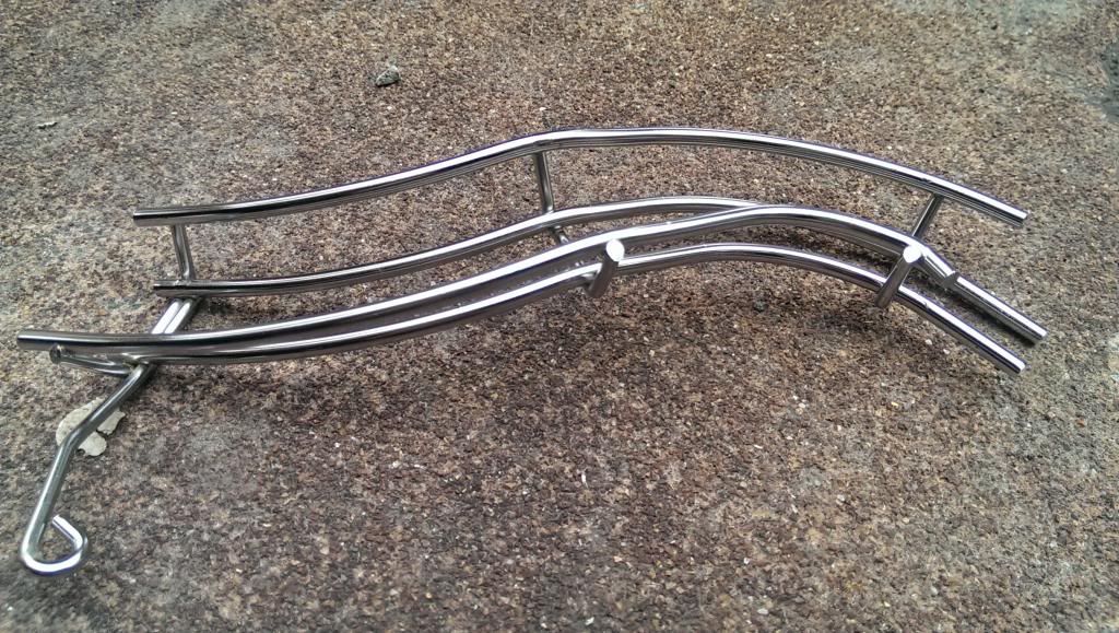

    I let these soak overnight and removed them from the brew. I hosed them clean, wiped them down with an old towel and then used a clean rag to get rid of the oxidation. I grabbed the toothbrush to remove any stuff stuck in the joints. Once this was done I wiped them over with the 000 pad. This took all of 15-20 minutes to do ALL of these wireforms. I know I have spent 20 minutes doing one small wireform before!

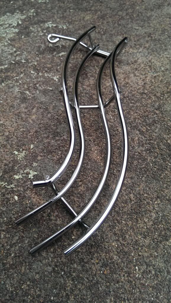

    Here are the results:
    http://s936.photobucket.com/user/spacies/media/2014-03-11170544_zpsd7929303.jpg.html][/URL]
    http://s936.photobucket.com/user/spacies/media/2014-03-11170512_zps31b2f780.jpg.html][/URL]
    http://s936.photobucket.com/user/spacies/media/2014-03-11170606_zpsfa0e6e7c.jpg.html][/URL]
    http://s936.photobucket.com/user/spacies/media/IMAG0426_zps51e85003.jpg.html][/URL]
    http://s936.photobucket.com/user/spacies/media/2014-03-11170853_zps05425155.jpg.html][/URL]
    There you have it guys. This is the easiest way to clean these things or any other chrome part be it pinball, automotive or whatever, but especially wireforms!
    Oh the Fish Oil! Give them a light spray and a wipe down. This will stop those pesky little rust spots ever coming back. It's an optional step so I'll leave it up to you. One place you will need to use the Fish Oil is on the inside of the legs. They just about always have rust on the back and especially down the bottom where the leg leveler goes through.

      One thing I really love about this is how the point where the wires touch each other (the welded point), which is usually tarnished and dirty, comes up so nice and shiny. It's all about the detail

                (Fish oil might collect dust or the sticky nature might cause slight drag on the ball)
