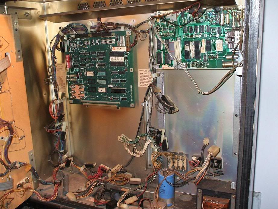

    Once I put the game up on legs I opened it up and decided upon the best course of action to get this game back up and running. The main CPU board had some damage, so I decided I'd look for a replacement first. A quick PM to Tony at the Pinball Shed had this sorted straight away. The replacement CPU arrived with a remote battery holder fitted, and the board itself was in very nice condition (Thanks Tony!). I have since repaired my origanal CPU and will keep this as a spare.
    Removing all the boards from the back box one by one.
    Yuck, what a mess!
