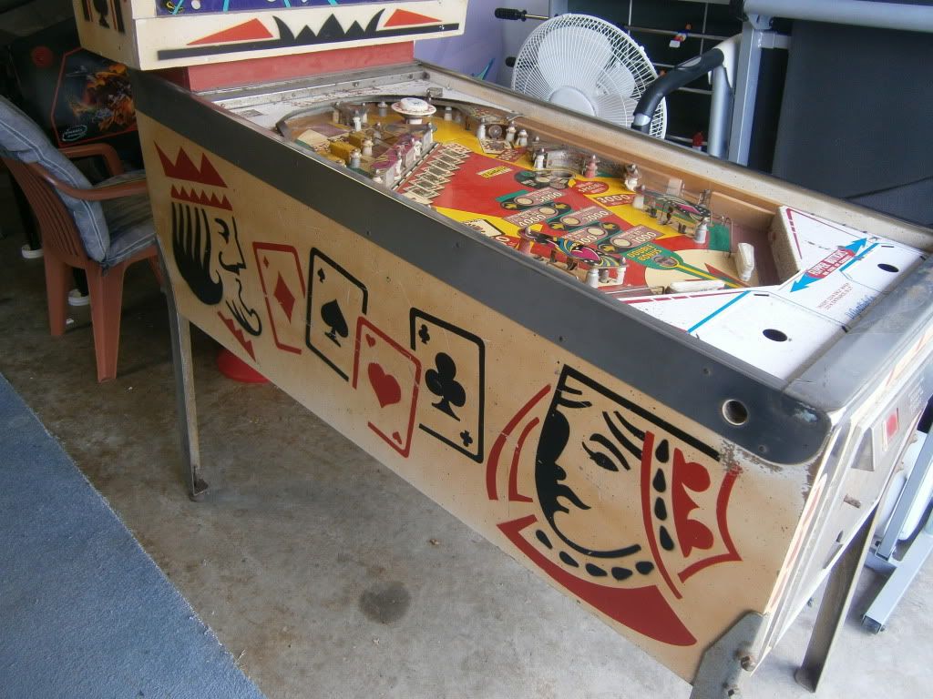

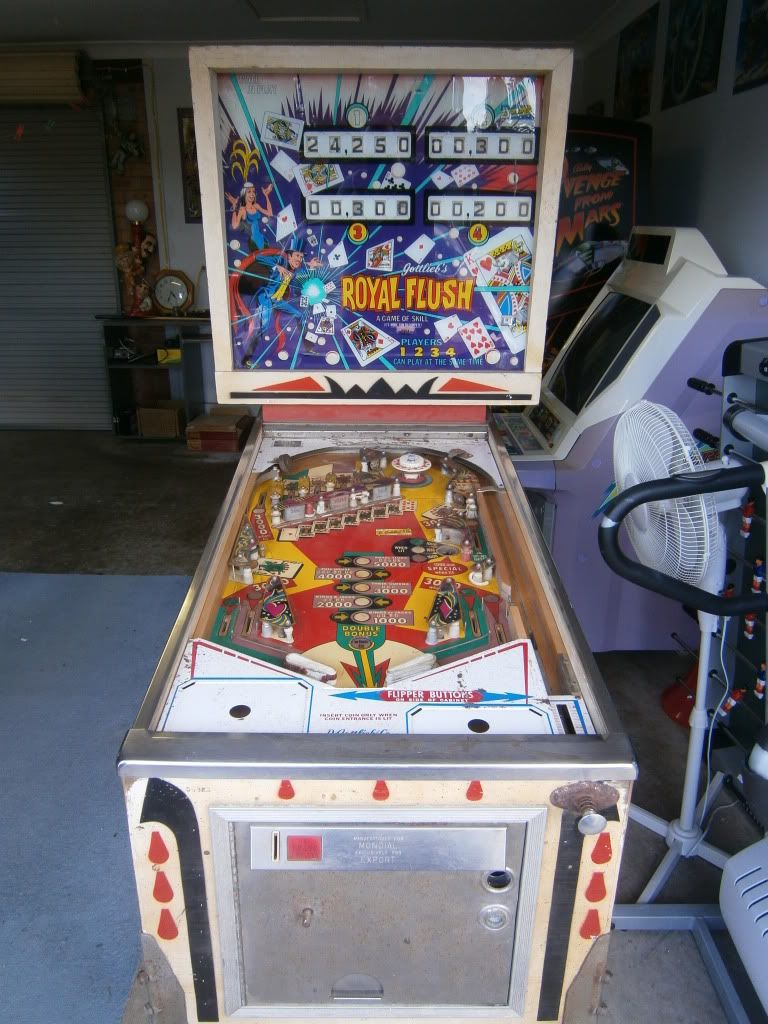

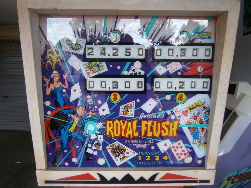

    Picked this up today from Edy. I once owned the 2 player version Card Whiz, and allways missed it. This one is very much a project machine, hasnt worked for decades maybe, and somewhat neglected somewhere in France (container pin, bought in a few years ago). Looks to be complete, be it rusty in places, and alot of what's plastic on the playfield has been smashed. The PF is excellent, well hopefully still so after the mylar comes off. Quite alot of work in it for me, but its one of the best players of its era, so well worth my time and money to fix. The BG is okish, good enough for me anyway. Thinking about using 90's posts, and spraying some of the crome bits (rusty) with colored paint, then clear them. PBR sell everything I need for this one, but I dunno, maybe a bit of moderisation wont look bad at all. How would a purple apron look, with a red lockdown bar?

    Yes, like this very much
    Second best Gottlieb pin of all time...really looking forward to watching you restore this Greg.
    She looks heaps better than how you described it!
    Yes, really like your ideas of going away from the factory output

            Looks like a nice machine Greg. Will be good to see how this progresses. Looking forward to the restore.
              Best of luck Greg it looks like a good solid base to start a project with :-)
                Looks pretty good to start with. Will be interesting to see the reno progress, particularly the mylar removal. Looks like it's torn down near the eject hole and a few sunk inserts so has to be done I guess.
                From what you can see of the mylar around the edges it looks like it is pretty thick and has shrunk over time, so hopefully it comes off cleanly.
                I'll watch keenly as I have a Card Whiz that needs a lot of work.
                  Looks like a great starting point Greg . That door is in heaps better nick than the 2 Gottliebs I have .
                  Will watch your progress with interest .

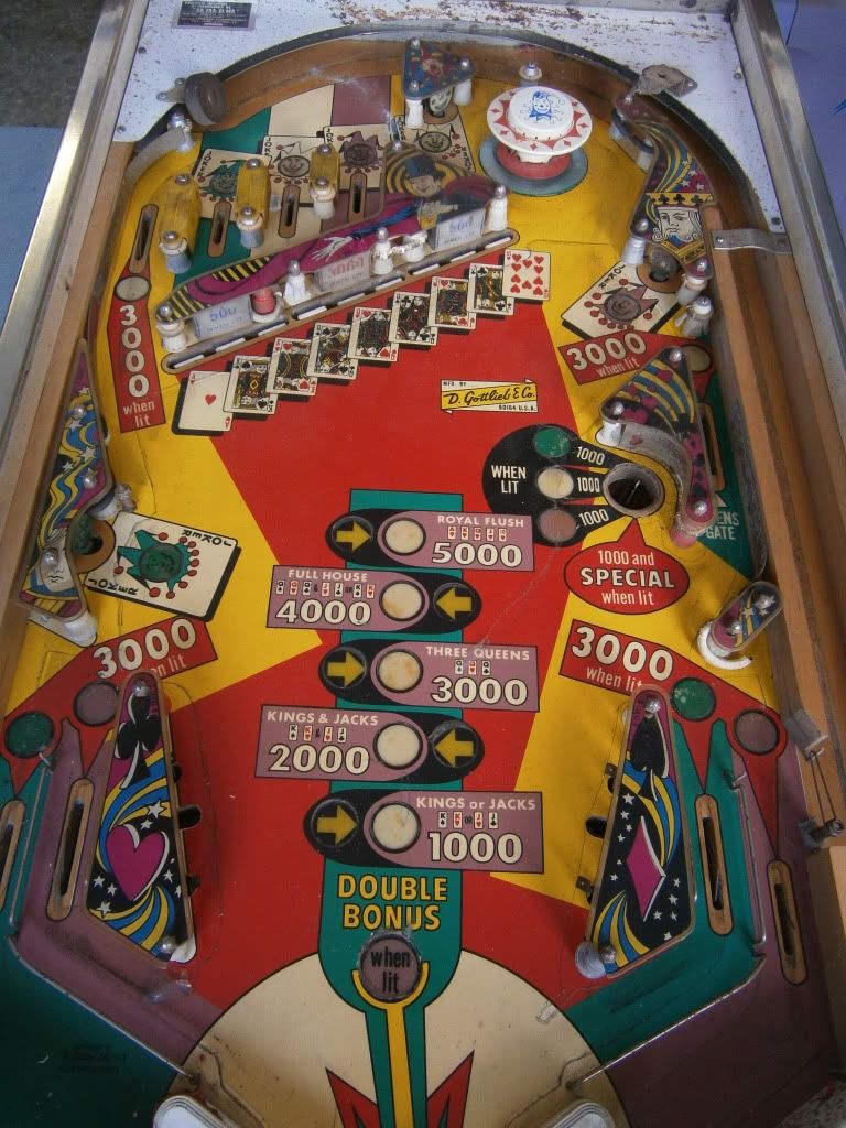

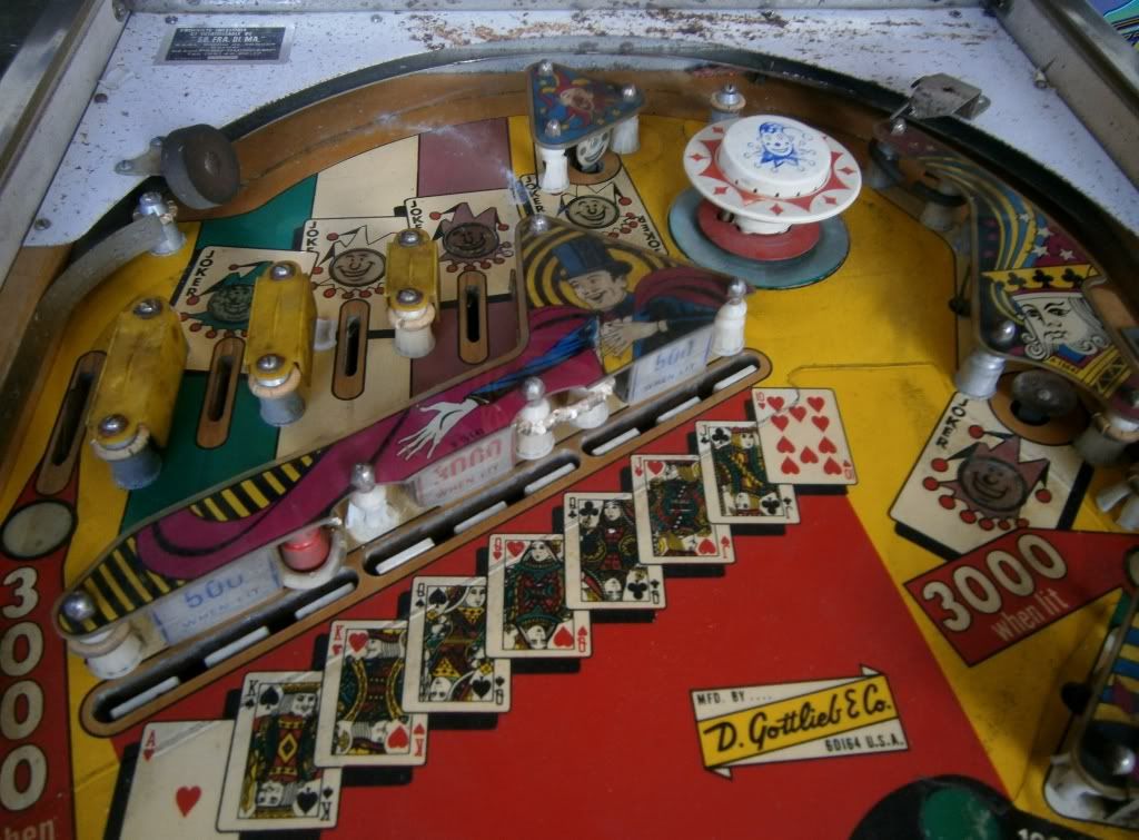

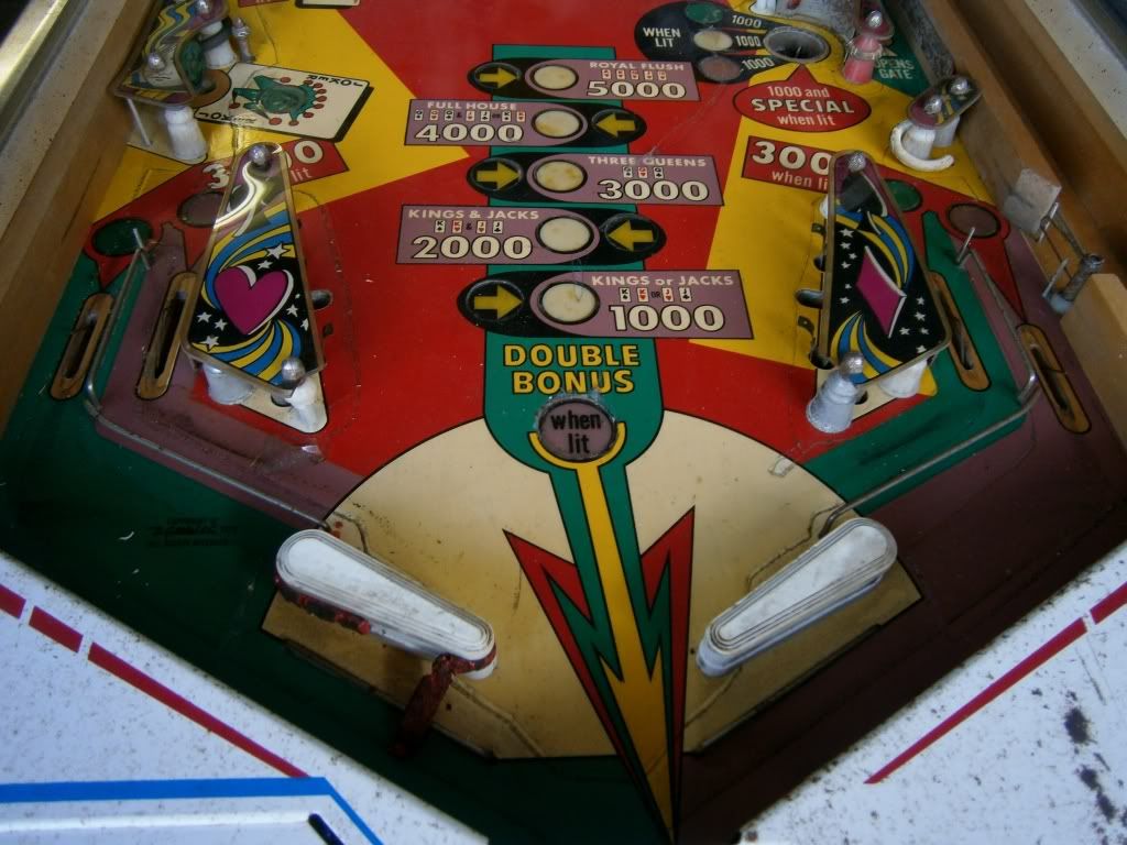

                    Mylar removal done, and dusted Heated the mylar with the hair-dryer, whilst the missus pulled gently (lol), and stopped every few inches to clean the glue away with euclyptus oil. Removed no paint at all, but discovered some loss where the mylar had worn through in places. Very happy with the results, and would definately remove mylar again (2nd time lucky Jeff ). Will look great after a polish with novus, just have to pop up the insert between the flippers first, the rest are flat .The top third of the PF was never mylared, so it will get the magic eraser treatment.

                    the top section will need magic erasering
                      That mylar protected the original paint very well!give it a few squirts of wax ,& it will come up great!..
                        Nice work on the removal of the mylar Greg, them colors look nice under that. remind me about the flipper bats.
                        Pity it wasnt all the way up like Spirit. Next sunny day I might attack it.
