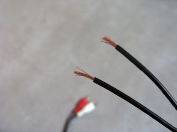

    - Cut off one of the ends:
    - The ground wires are loose on the outside, separate them from the insulated wire and twist together. Also strip the ends of the insulated wire:

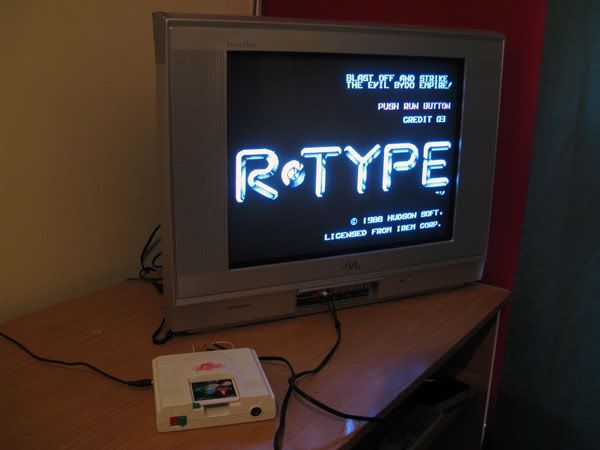

    - Proof is in the pudding:

                      Quick update, just as easy to perform the same technique to extract RGB from the expansion port of the PC Engine console. Most people do this in conjunction with a simple external amp, to boost the RGB signal, but with my TV it doesn't appear totally necessary.
                      ^ My camera is making it look darker than what it is to the naked eye.
