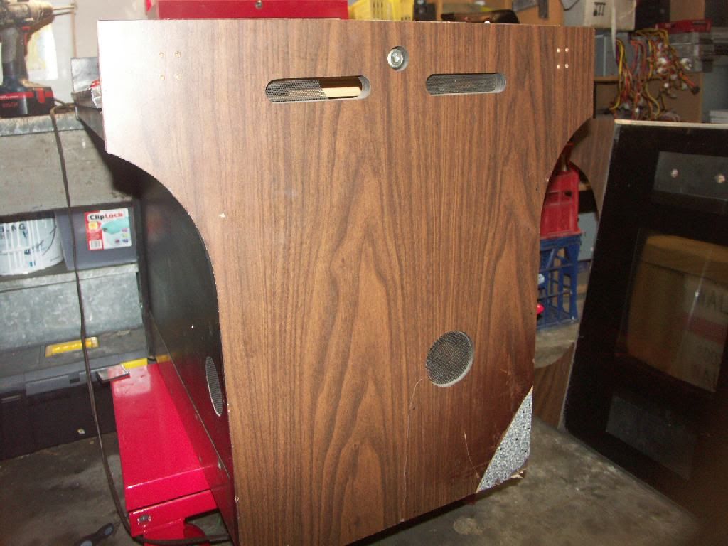

    Had a bit more or a poke around and notice that the sides are covered in this crappy thin stick on veneer, decide to pull it off to reveal the nice original panel work. Looks great on one side,
    not so great on the other side. Bit of a chunk missing on the bottom corner, never mind, better that it was..
