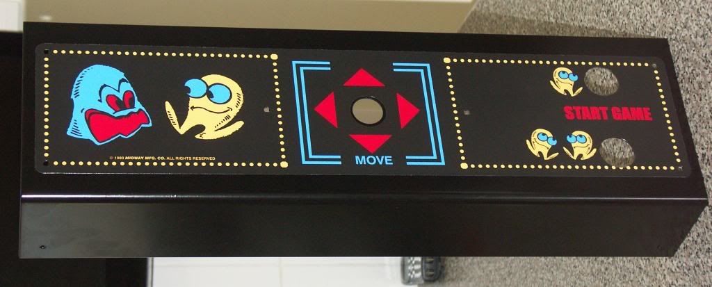

    Applied the CP overlay this morning wilth little deliberation ater getting the CP back from the powder coaters yesterday.. AK called over and was pretty keen to see the 'process'..
    Really simple:
    Wipe down the CP
    Mix half a cup of water with small squirt of detergent into a squeeqy bottle and shake
    Spray a light coating of above mixture over the control panel
    Peel backing paper off the overlay
    Apply overlay to the CP and carefully slide to its best location
    Carefully squeege and excess moisture from under the CP..
    - I used a plaster spatch but it was a little rough -recommend proper rubber squeege - We wanted it done quick, and it was close to hand..
    Stand back, admire and take a picture
    Process time - less than 5 minutes.

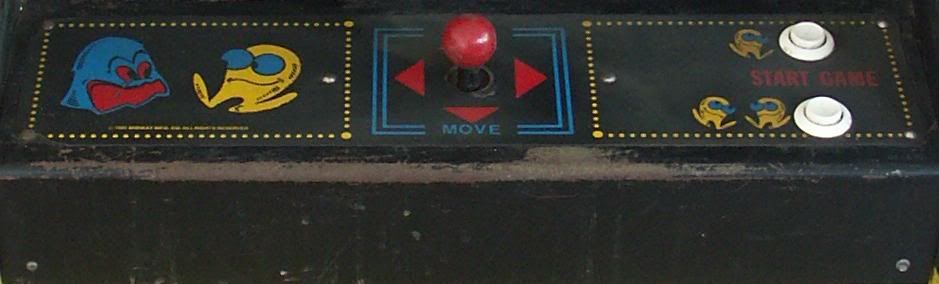

    Before Shot:

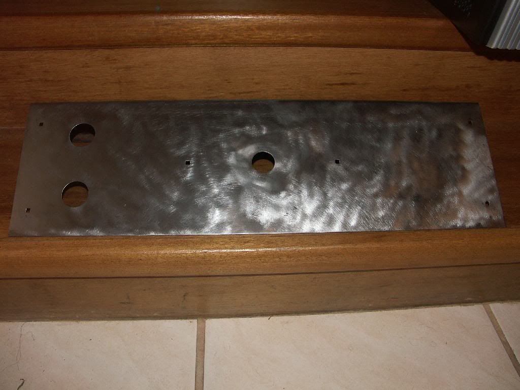

    Prepped before powder coating:
    After CP overlay applied
    Nice work WOKA, how did you re-create the artwork ?
      I cheated, I bought an overlay via Ebay. I have the AI file, but thought it quicker to buy the overlay.

          +1 for wet method. I'll be using this method from now on for sure.
            same
            i saw the pros use the wet method on mine comes up smick i was unsure but it doesnt look like shifting anytime soon

              Is it the angle of the flash or the colours on the new overlay look more washed out than the original?

                Does powdercoating have enough durability for the area surrounding the inlay?
                We're the renegades of funk
                  Powdercoating will be better than pretty much anything - very hard wearing !

                    HAving the CP only powdercoated would be pretty uncomfortable though with the cold etc wouldnt it?
                      Yup, it's just a like paint, but in powder form and baked on (I used to be a powder coater)
                      Very schmick finish and you can get a BUNCH of different colours and finishes like hammertone, satin, matte and the like.

                        I have been sandblasting powder coat off my coin door this morning, hard shit to get off, is far stronger than paint.
