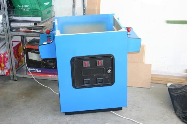

    So one day I decided that I wanted an arcade machine. I have fixed a few boards in the past, and really wanted a good ‘home’ for them. First off I wanted an upright but got vetoed by the boss. So a cocktail machine it was. After a long period of scouring eBay for a suitable one, I thought to myself “Self, why don’t you try building one?”. Good idea, in theory. Now I haven’t built anything out of wood since Tech school 20 years ago. I’ve never used a router, jigsaw, or a circular saw.
    Well, it was time to learn. I poured over the brilliant Pac-man CT plans freely available, purchased/scrounged materials and below is the result. Only real mistake? Not taking enough photos while I was building it.
    Slapped together, only the dowels are holding it together, no glue. Little Miss Junior GTG! is having fun stuffing coins in the coin mechs.
    Assembled. Note, I didn’t use metal CP’s, I made them out of wood. I’m pretty happy with the way they turned out.
    All the various bits opened up.
    I designed the coinbox from scratch. Not too bad…..
    Spraybooth. Years ago I spray-painted a car. Never again. I didn’t want to get paint all over my garage (workshop?) so I built a claytons spraybooth. All up cost was about $10. (Dropsheets, stole the missus’ pegs, already had rope.)
    Paint finished, CP’s assembled, T-molding and various bits installed.
    Time to cut out a top. I purchased a Galaxian underlay from …. Somewhere… I can’t remember at the moment, and just marked it out on MDF.

    The current state of the machine. Mrs GTG! and Junior GTG! are busy playing Ms Pacman. I got the glass made to (almost) fit. It’s a tad smaller than the wood top. Sanding required.
    I still have to router out the slot for the t-molding on the top, and pull it apart to paint it black. The wiring also needs tidying up. But I have found that now that it’s actually working, I can’t stop playing it for long enough to finish it!
