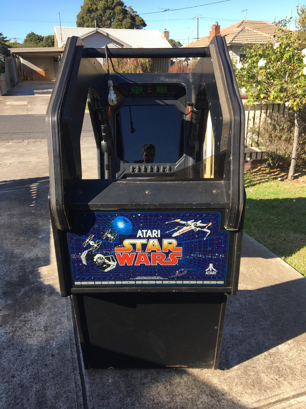

    So I hired a van and dragged home the undisputed king of early 80s arcade machines, an Atari Star Wars Cockpit.

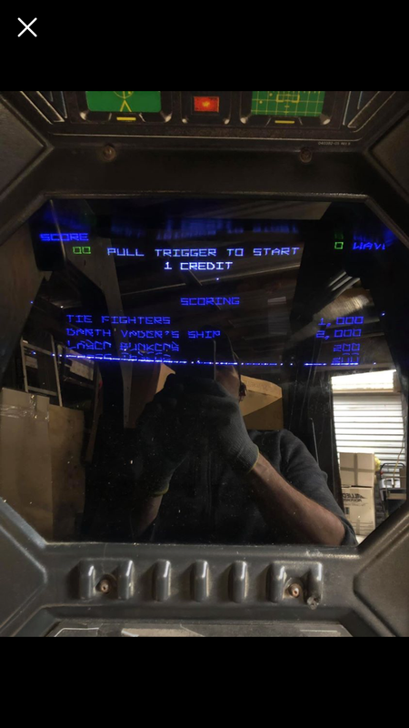

    The seller described it as working, but it was a long way from being 100%. The vector monitor had only partial vertical deflection, leaving the bottom half of the screen blank...
    ... plus a slightly worrying lack of red in the image - hopefully not a bad tube.
    It also had controller fault, the roll axis worked, but pitch didn't register at all, and there were no signs of any audio, not even a pop on power-up and no amplifier hum. Lastly the game crashed and rebooted a number of times during the time it was running too.

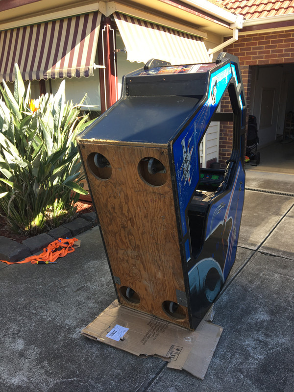

    The first challenge was how to get a 196KG cabinet out of the van single-handed, at short notice and with a 30 minute deadline to get the van back before early bird pricing turned into a day hire.
    After a few failed attempts at ramps I ended up rolling it out onto its nose and driving the van forward before lowering the lighter back end onto its wheels.

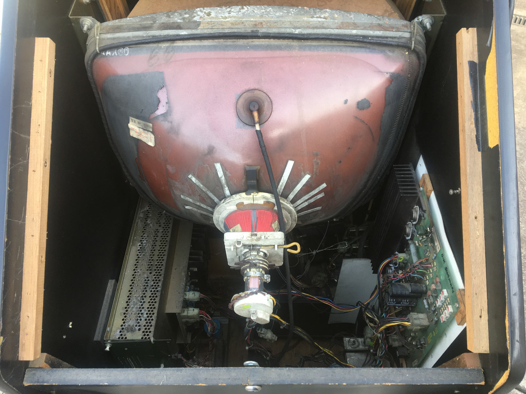

    Time to see what lies beneath!
    I had no keys for the locked coin doors, or the back panel, so I unscrewed the lid and got my first look inside in daylight, I'd had a quick look in the sellers garage but the lighting was poor and my phone torch weak.

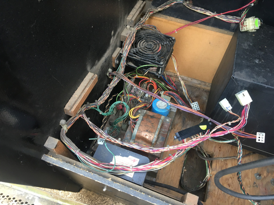

    Everything seems to be there...
    ... a somewhat trashed looking 25" Amplifone monitor, which looks like it has got wet at some stage.

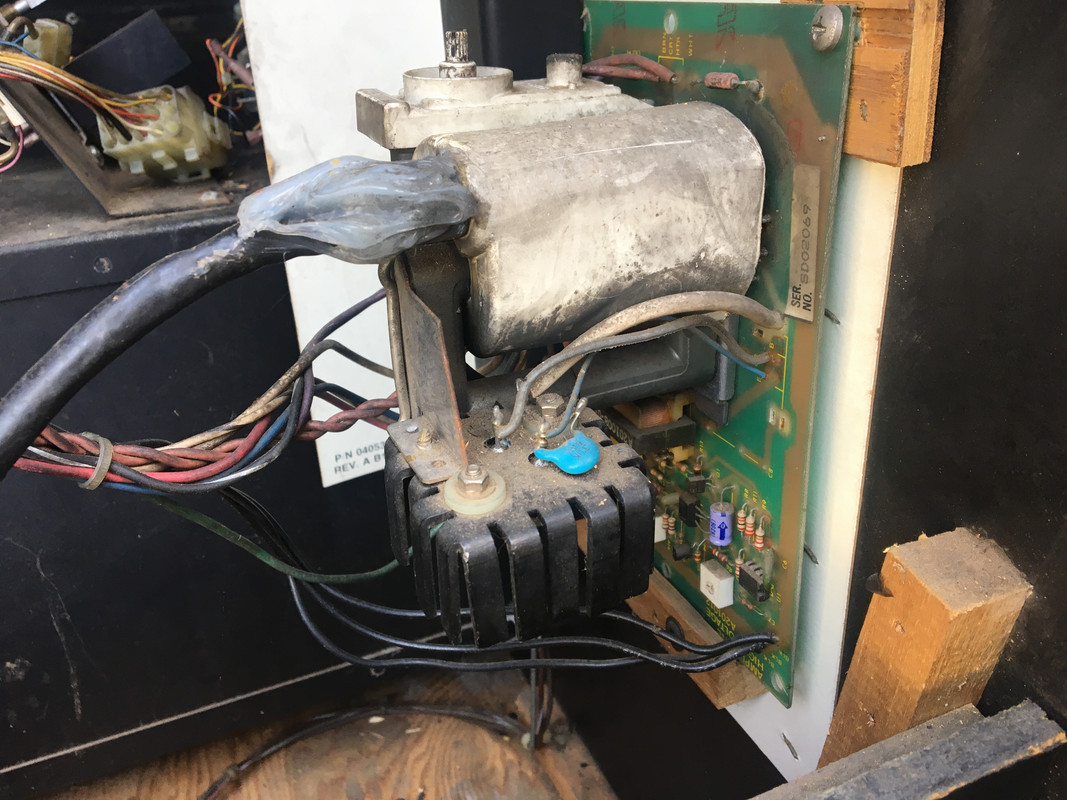

    Original deflection board, complete with burnt craters in the PCB from how hot these run.
    Original high voltage board, with fugly bodged-in line output transformer and gallons of bathroom sealant to keep the magic sparks in.
    Finally, right at the bottom in the dark....
    ... a fruity mix of mouse and rat muesli.
    Mouse crap is one thing, but they piss almost constantly, and chew anything they can get their teeth into.

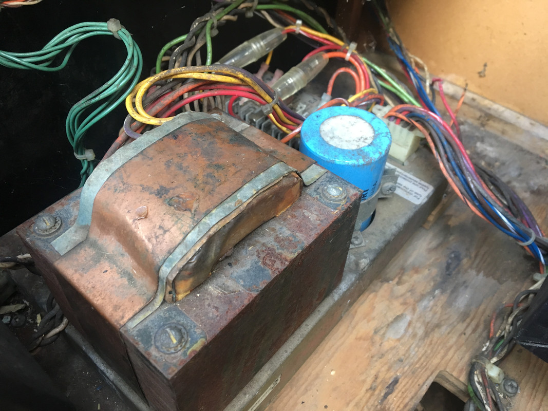

    Original power brick - rusty!
    Wiring harness - chewed up, and filthy.

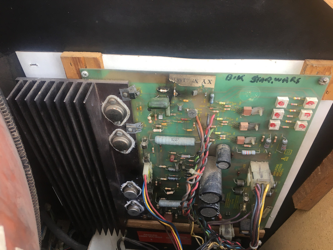

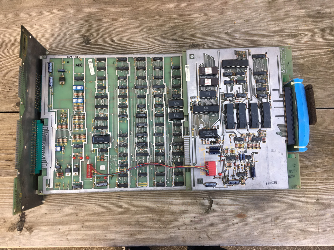

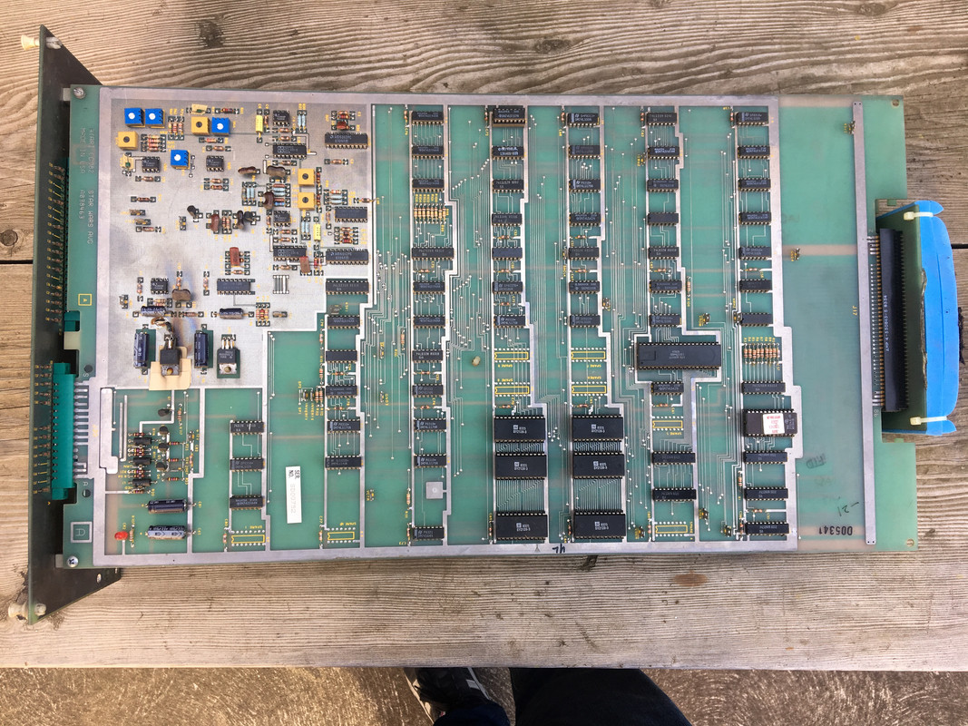

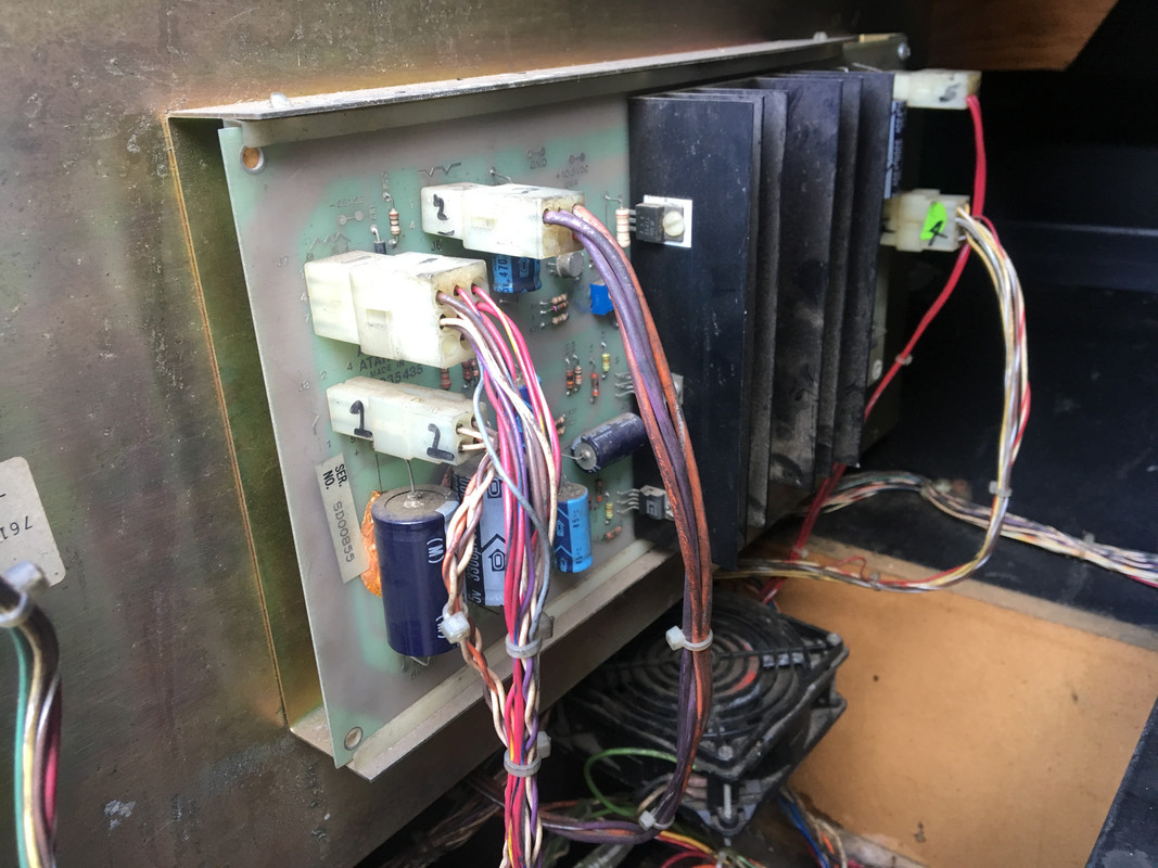

    Audio Regulator II PCB - no damage, just dirty, being vertical probably saved it...
    ...mounted to a rusted, PCB cage...
    ...which thankfully contained a pretty mint PCB.
    An interesting mix of serial numbers in this cab. The two monitor boards and the power brick are all from machine SD02069 , which is probably the serial number of this cabinet, but the main PCB is SD02073, the vector PCB is SD00752 and the audio board is SD02070. Aside from the vector board all of these came from machines within 4 serial numbers of each other, so I can only assume this was owned by a company that bought a fleet of these and ended up cannibalising them for parts around to keep a declining number of them running.
    Thankfully the PCB cage took all the damage from the squatters, mice may leak constantly but the volume is low, I guess there was never enough to drip through onto the PCB.

    Power brick out...
    ... a 20c discount at least, the cab just got cheaper.

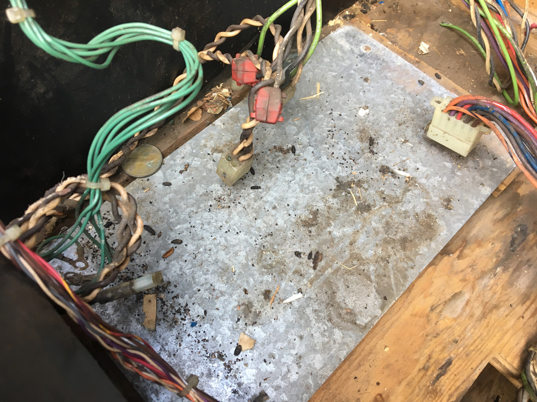

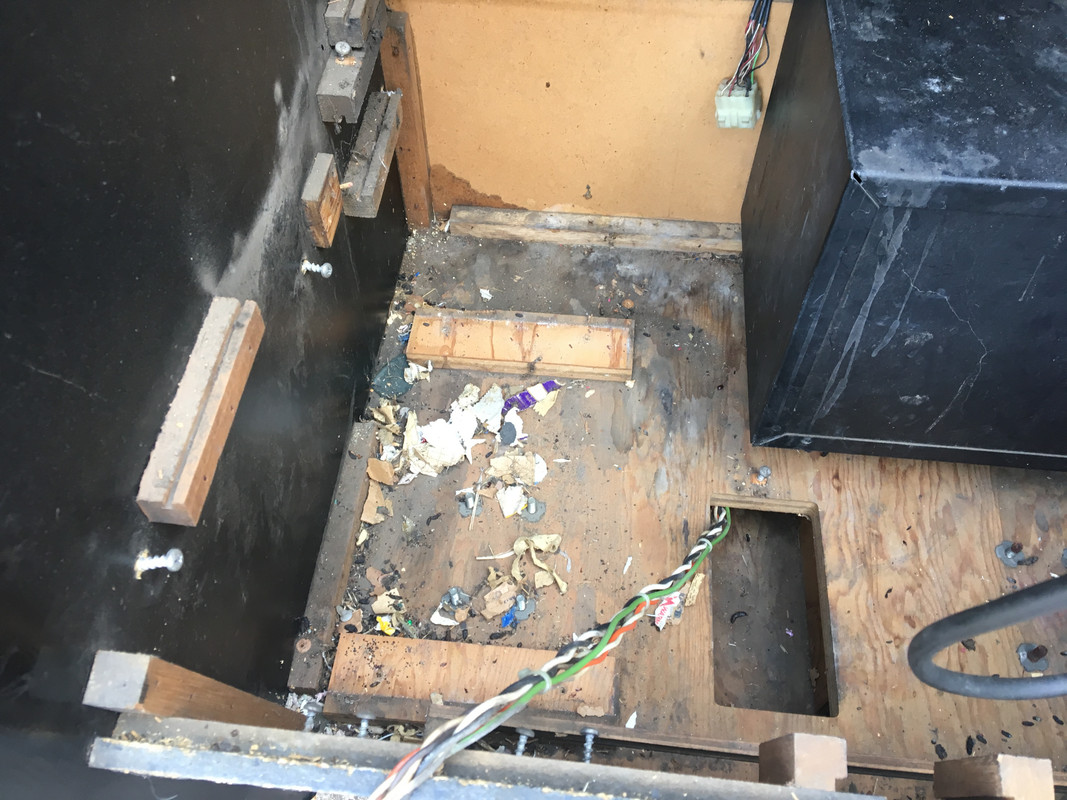

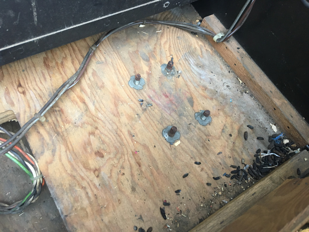

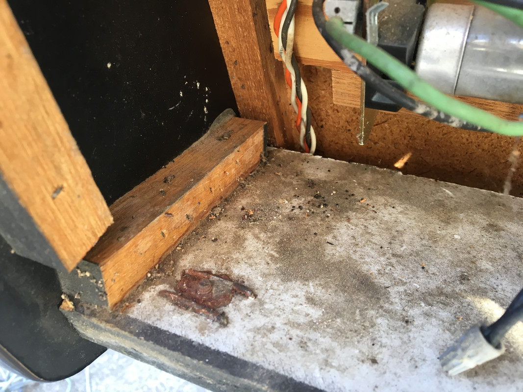

    As I had to roll this out of the van onto it's nose all the crap had rained down to the front of the cabinet.
    Apparently these cabinets are a magnet for rats and mice, presumably due to the wiring tunnel that's accessible at the rear wheels ans runs to the front compartment. It is pretty much a perfect artificial burrow for them, they like it, so they move in.
    I tipped it back on its nose and gave it a good thumping until the sound of raining shit stopped.

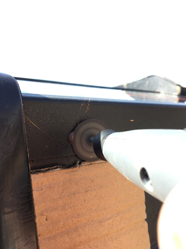

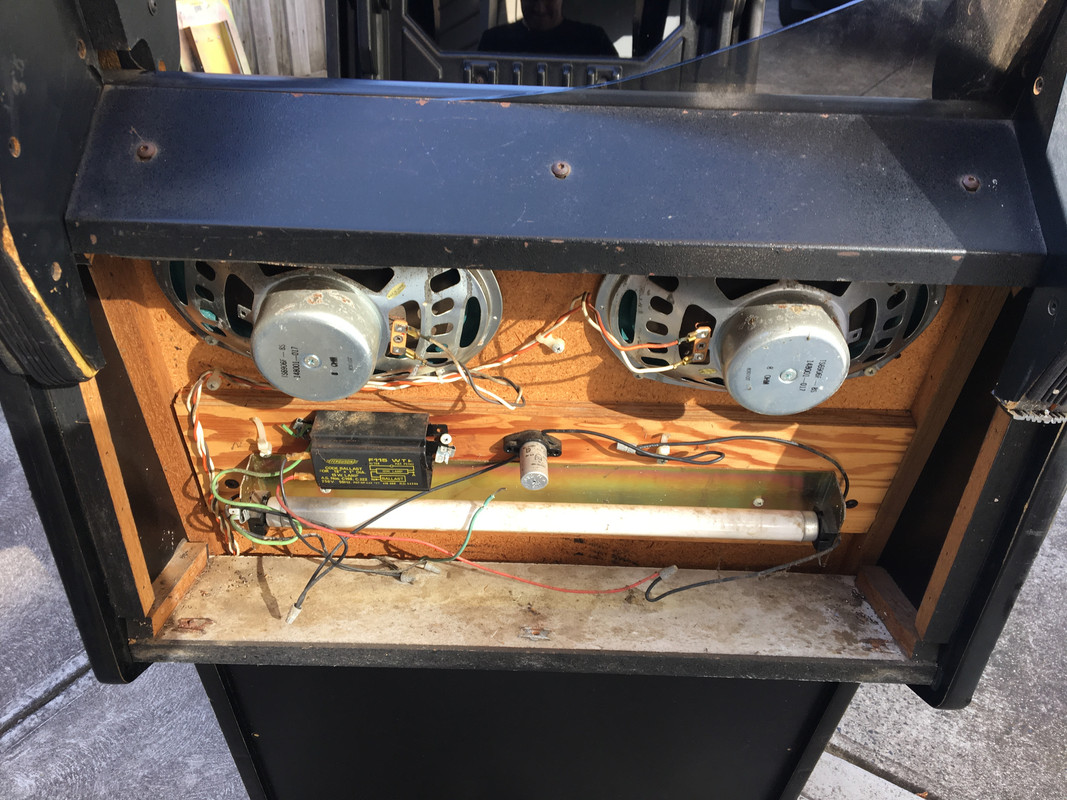

    While it was arse-end-up I went looking for other areas the mice had been camping, starting at the rear marquee light box. To drop the glass out I needed to remove 3 bolts, 2 could be persuaded to turn, the third would not budge and I ended up stripping the head.

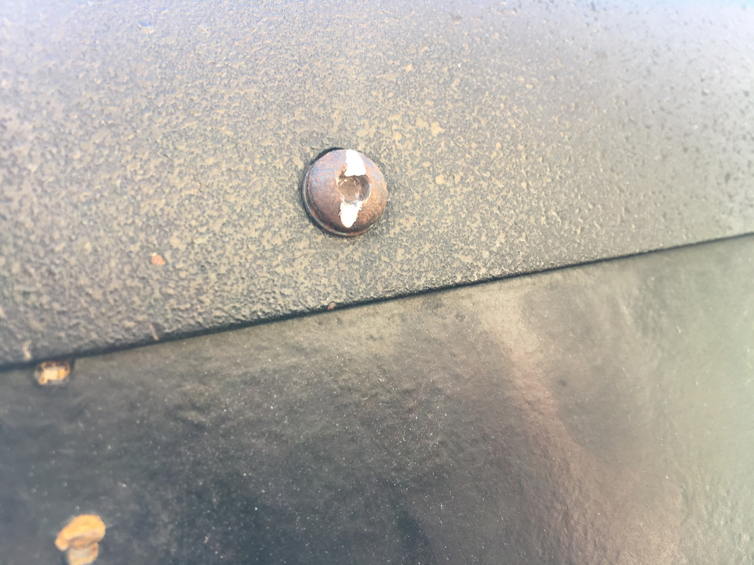

    Even dremeling a slot for am more persuasive screwdriver didn't work...
    ... so I had no option to but to cut it off.
    Which got me in here...

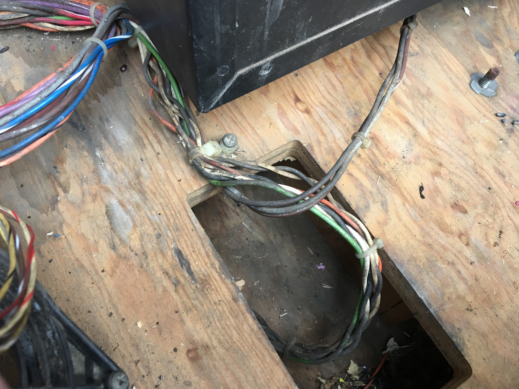

    ...not too bad, more mess but no major damage, all the crap would have rained out earlier, but that's why the bolt wouldn't move, it's in the corner that took the most mouse damage.

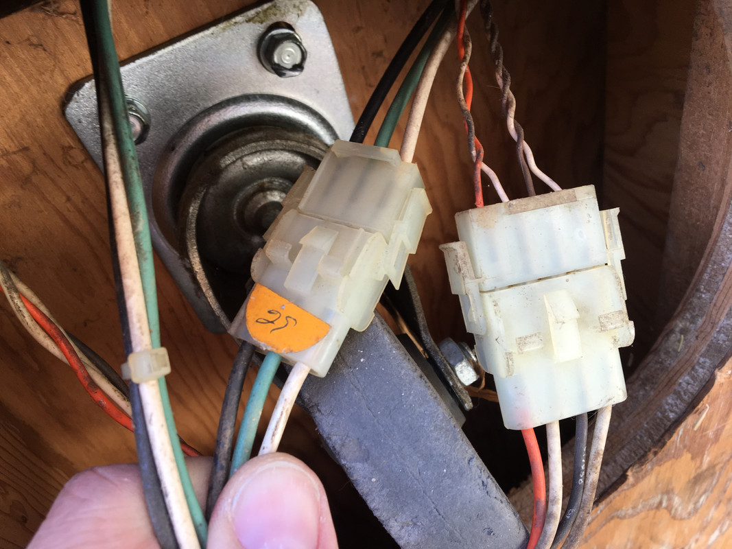

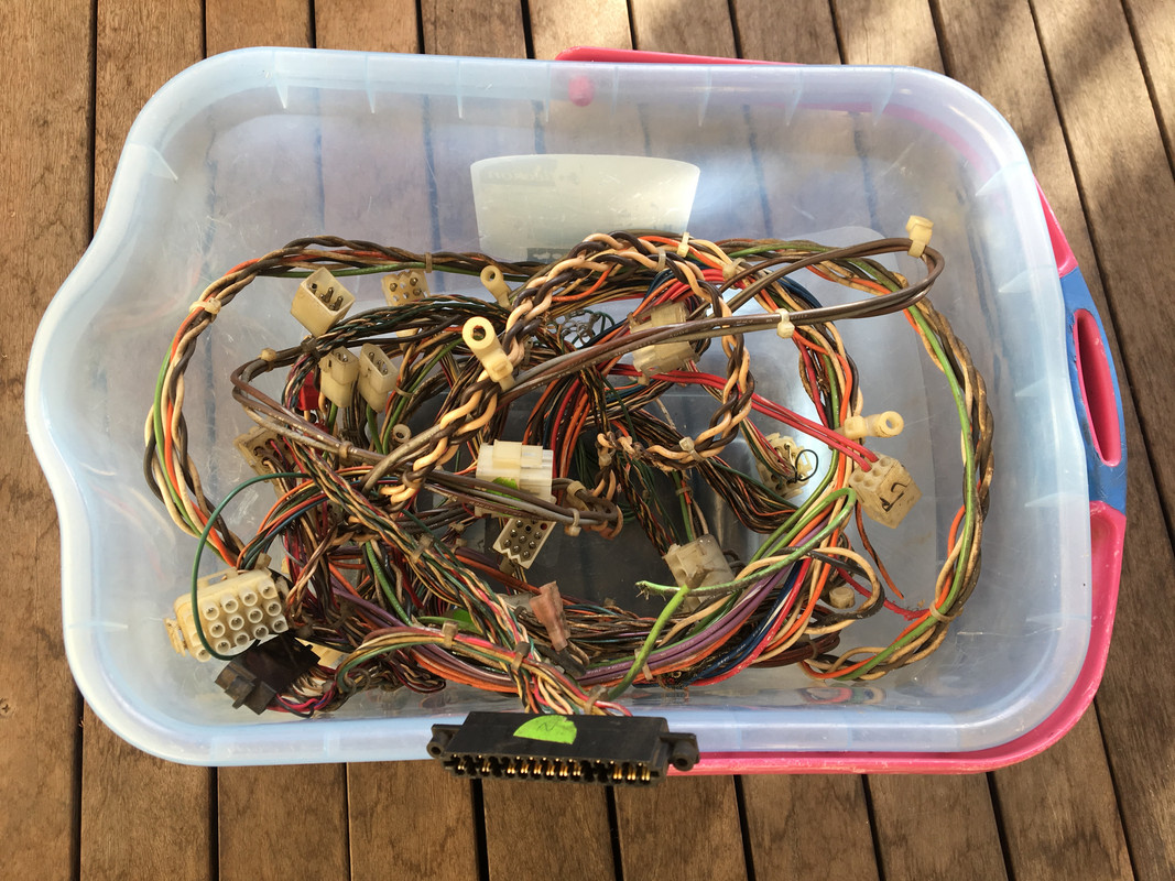

    With access to the rear wiring I could disconnect the wiring to the fluoro tube and the speaker interconnects which loosened things up enough to get to the actual connectors up inside the wheel well.
    Harness pulled out!

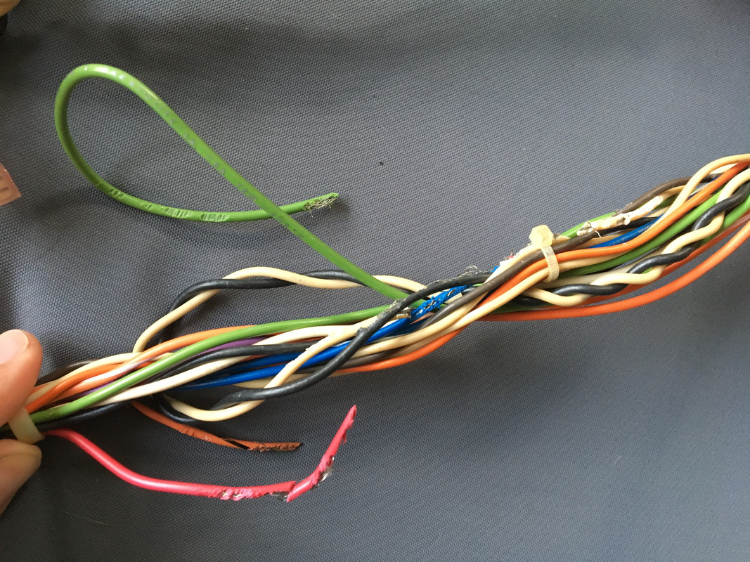

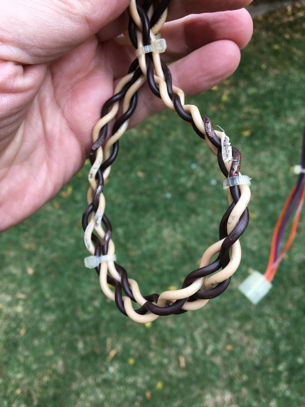

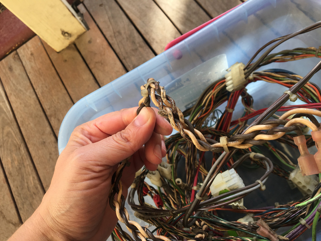

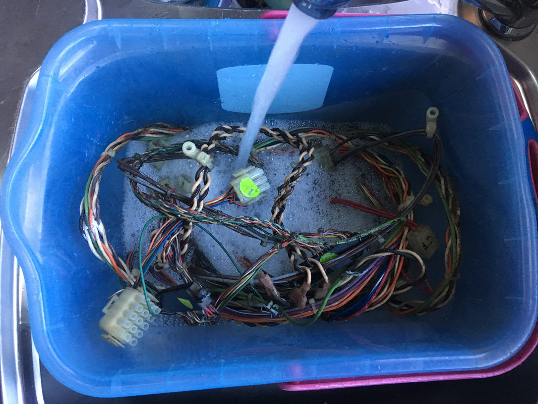

    Filthy, and chewed to hell in places, the mains wiring seems to have been especially tasty.

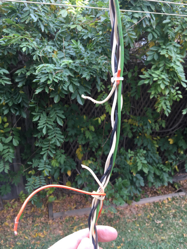

    Bath time, a soak in hot water + Napisan and a scrub until clean...
    ...and an afternoon swinging in the breeze.
    With it clean the damage didn't look as bad, it's limited to three sections, the mains switch loop...
    ...speaker connections towards the rear of the cabinet...
    ...and not sure what this section is yet.

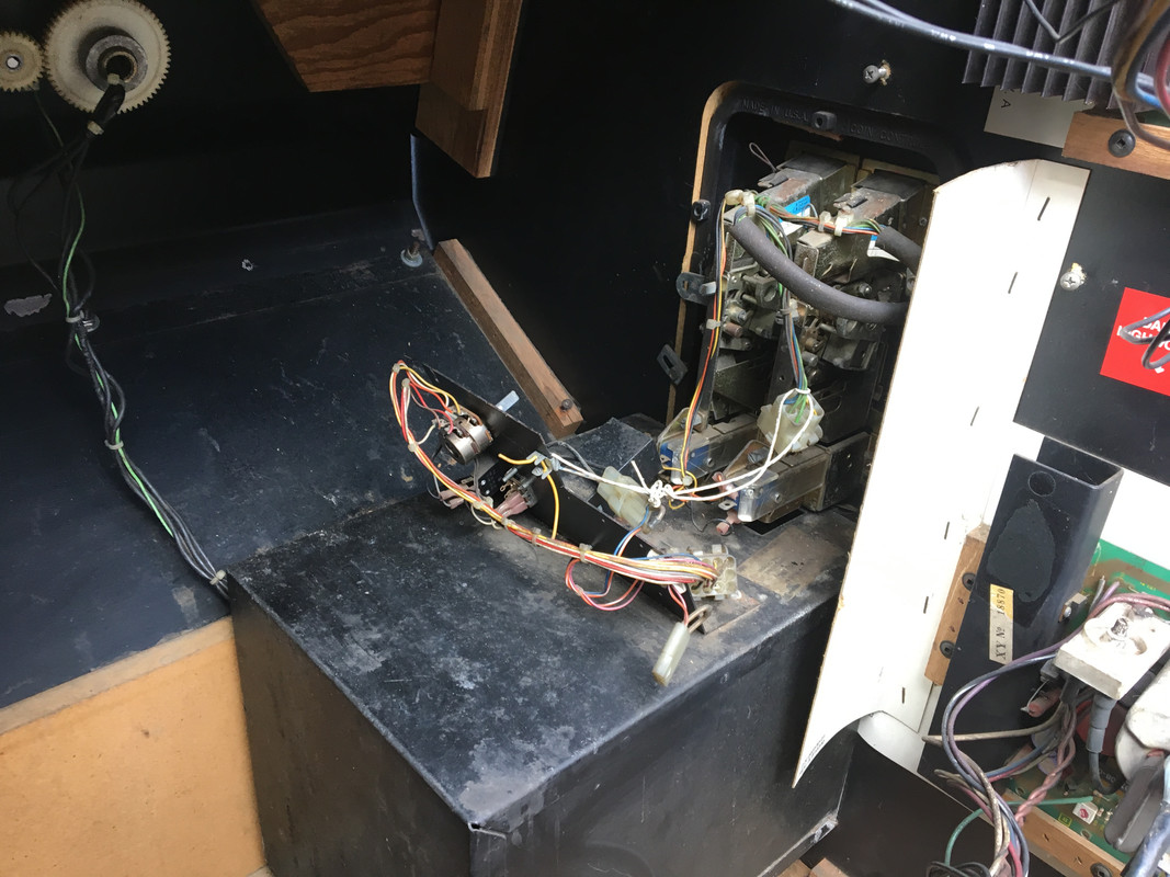

    To properly clean out the main compartment I needed to remove the coin box cage which seemed to be the foyer of the mouse motel.
    This is hooked over the bar between the two coin doors and clamped to the side of the cabinet by the bolts and catches on the inside. Without keys the simplest option for the coin mech door is to undo the nut that holds the locking arm in place and open the door from the inside.
    Hmm, there's something in there!

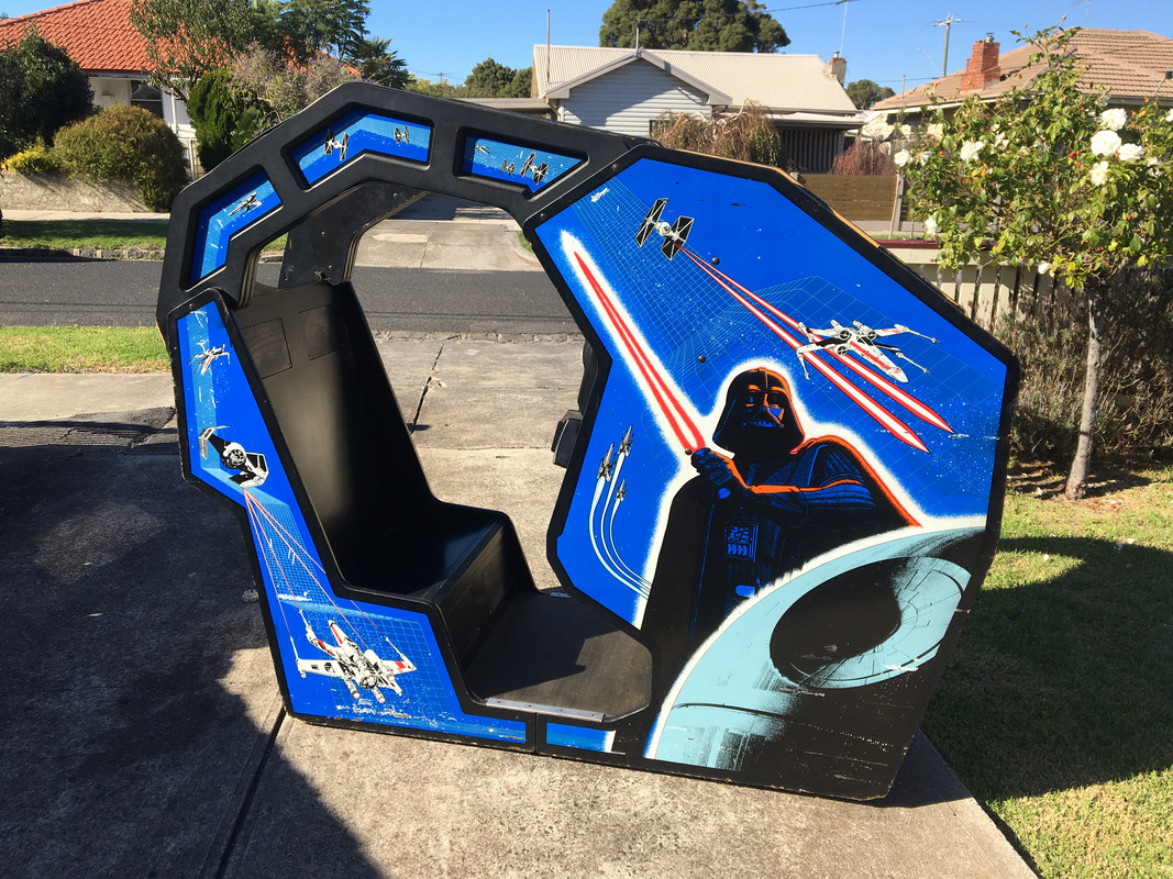

      The marquee area got a scrub down too.
      https://postimg.cc/bsXD1M4B][/url]
      All in all the mouse damage could have been a LOT worse, and as the cat had lost interest in the cabinet I reckoned it was clean enough to be let in the house.
      At this point the tear down was complete, basically everything except the controller. Time to focus on the heap of filthy parts in the corner of the garage, before they get too comfy there, or I wake up and find 4 years have gone by like last time.

                        Power brick up next, shame about the transformer...
                        https://postimg.cc/0K15F6R1][/url]
                        ... filthy, rusty and probably strongly mouse scented when warmed up.
                        A session with a wire brush and some polish got me some way...
                        https://postimg.cc/jWVsLw2w][/url]
                        ...but as my patience faded I resorted to sand paper.
                        https://postimg.cc/v1dsGJ25][/url]
                        The copper strap looks like it is there to hold the transformer together, but it's purpose is actually to cut down the stray magnetic field leakage that would otherwise annoy the monitor. It was originally lacquered but that had let go in places so I stripped it all back on the upper faces and polished the copper back to a shine.
                        With the wires cleaned and everything rubbed down it got masked up...
                        https://postimg.cc/crpqmqSP][/url]
                        ... and hit with a few coats of spray paint for a massive improvement...
                        https://postimg.cc/9RFsMCdw][/url]
                        ...then the masking was reversed and the copper strapping got a final polish and three coats of lacquer to keep it from re-tarnishing.
                        https://postimg.cc/LY223czm][/url]
                        Winning!

                          The coin box and service panel paint jobs were done, leaving only the wiring harness to sort out.
                          https://postimg.cc/9R7fF6G2][/url]
                          Before bath-time the switch, volume pots and the coin counter had to come off for a manual wash, as they wouldn't appreciate water.
                          https://postimg.cc/xXfqyFSG][/url]
                          The harness went in the sink for a scrub and the pot got a clean by hand before being soldered back on.
                          https://postimg.cc/dZG9T285][/url]
                          Was feeling protective of the paint job so a couple of fibre washers ended up preventing the nuts from chewing it up.
