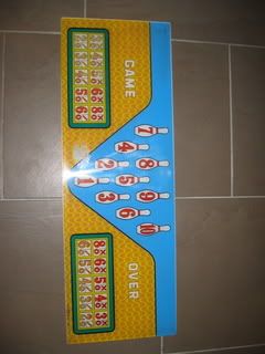

    Backglasses – both 9/10 – here is the upper backglass, there are a couple of spots that I plan to fix up with some photoshopping.
    Here is the lower backglass. This has one spot that will need a little touch up as well.
