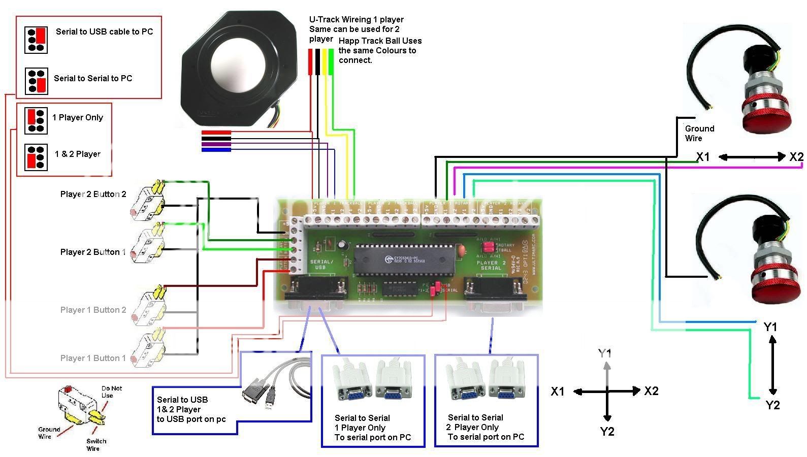

    I have been working on some easy to understand guides for some other users on how to install some different PCB's for Mame systems and Jamma Arcade systems. Thought id post them here in case some one may find a use for them. Ill add more as i make them ...
    I-Pac
    J-Pac
    Opti-Pac
    Pac-drive LED PCB[/b]
    [b]Mini-Pac

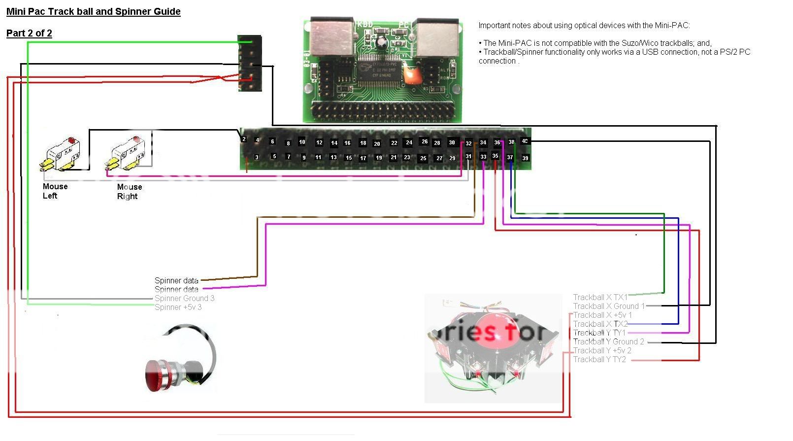

    Mini - Pac Wiring Guide
    By Mayhem
    40 Pin Connector x = polarizing Key
    __________________________________________________ ______________
    -- 0 0 0 0 0 0 0 0 0 0 0 0 0 0 0 0 0 0 0 0 --
    -- x 0 0 0 0 0 0 0 0 0 0 0 0 0 0 0 0 0 0 0 --
    40 Pin Connector numbered - X = polarizing Key
    __________________________________________________ _______________
    -- 2 4 6 8 10 12 14 16 18 20 22 24 26 28 30 32 34 36 38 40 --
    -- X 3 5 7 9 11 13 15 17 19 21 23 25 27 29 31 33 35 37 39 --
    Connector Pin 40, Ground 1 (Optical Only)
    [Not used] Pin 39
    Trackball X TX1 Pin 38
    Trackball X Ground 1 (Power harness)
    Trackball X +5v 1 (Power harness)
    Trackball X TX2 Pin 37
    Trackball Y TY1 Pin 36
    Trackball Y Ground 2 (Power harness)
    Trackball Y +5v 2 (Power harness)
    Trackball Y TY2 Pin 35
    Spinner data Pin 34
    Spinner data Pin 33
    Spinner Ground 3 (Power harness)
    Spinner +5v 3 (Power harness)
    Top Colour Group Mouse Left Grey Pin 32
    Mouse Right Purple Pin 31
    Coin-P1 Black Pin 30
    Coin-P2 White Pin 29
    Start-P1 Red Pin 28
    Start-P2 Brown Pin 27
    P1 Left Yellow Pin 26
    P1 Right Orange Pin 25
    P1 Up Blue Pin 24
    P1 Down Green Pin 23
    P1 Switch 1 Grey Pin 22
    P1 Switch 2 Purple Pin 21
    P1 Switch 3 Black Pin 20
    P1 Switch 4 White Pin 19
    P1 Switch 5 Red Pin 18
    P1 Switch 6 Brown Pin 17
    P2 Left Yellow Pin 16
    P2 Right Orange Pin 15
    P2 Up Blue Pin 14
    P2 Down Green Pin 13
    P2 Switch 1 Grey Pin 12
    P2 Switch 2 Purple Pin 11
    P2 Switch 3 Black Pin 10
    P2 Switch 4 White Pin 9
    P2 Switch 5 Red Pin 8
    P2 Switch 6 Brown Pin 7
    P1 Switch 7 Yellow Pin 6
    P1 Switch 8 Orange Pin 5
    P2 Switch 7 Blue Pin 4
    P2 Switch 8 Green Pin 3
    Ground Grey Pin 2
    Polarizing “Key” Pin (not used) Pin 1
    10 Pin Connector x = polarizing Key
    ___________________
    -- 0 0 0 0 0 --
    -- x 0 0 0 0 --
    ___________________
    10 Pin Connector numbered - X = polarizing Key
    -- 2 4 6 8 10 --
    -- x 3 5 7 9 --
    X = polarizing Key
    2 = +5 Volts (3)
    3 =
    4 =
    5 = Ground (3)
    6 = Ground (2)
    7 = +5 Volts (2)
    8 = +5 Volts (1)
    9 =
    10 =
