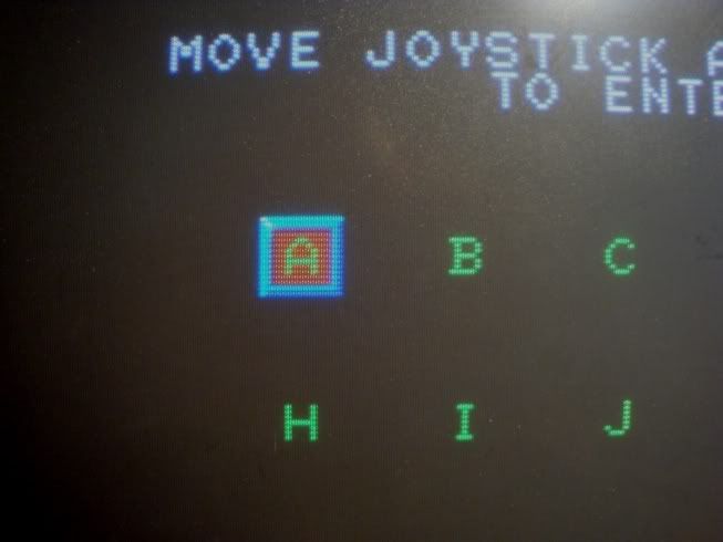

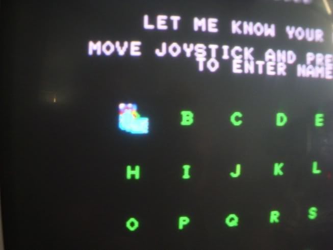

    Initially I thought that was the end of it but the game did odd things. The sprites were unstable or just plain wrong. The icon you control to enter your initials was odd...

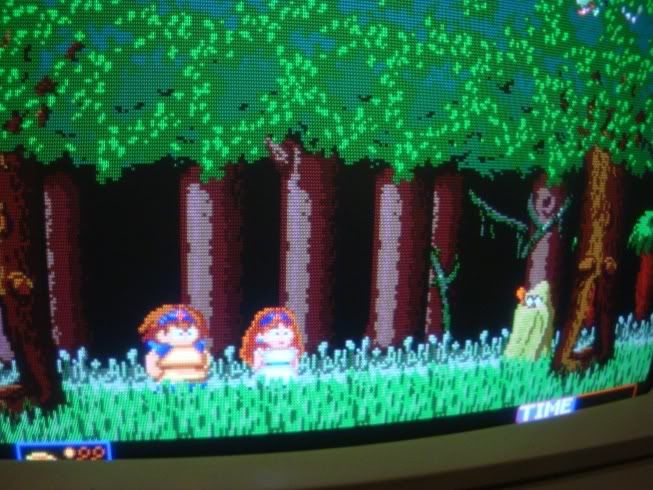

    and the bad guy displayed during the intro was just a couple of fireballs

    So I went back to the address lines with the scope, interupting the address pins on ROM 1 actually improved things no end, the letter selector icon came good
    and I got half the bad guy back.

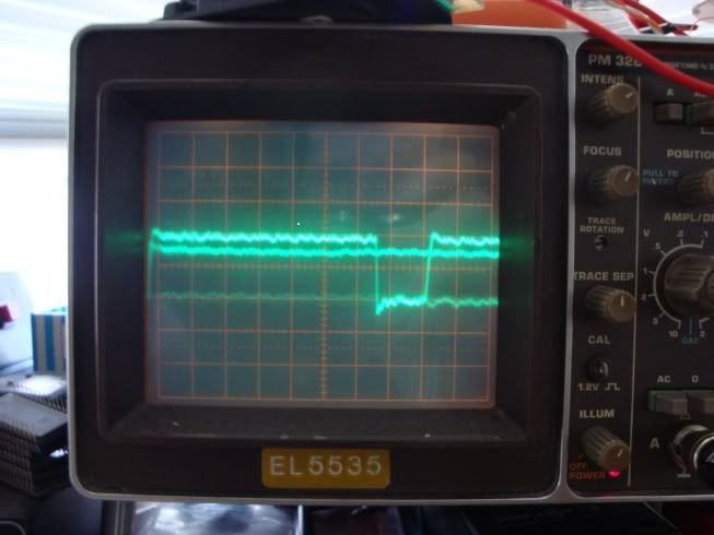

    Most of the address lines looked fine on the scope
    but pin 3 looked unwell, very subdued.
    Address lines are input lines so I went over the nearby 74LS374 (often used on busses) with my meter set to continuity beeper and found that A7 (pin3) connected to pin 6 on the 374 at B10, this was the output pin of the second gate and the input pin signal looked fine. So I desoldered the 374 and expected it to test faulty, except it passed all tests.
    So I powered up the board while the 374 was missing and hit the chip holes with the scope, all of them had activity on them except for pin 6 which was at logic zero and quiet.
    Spent a while removing the ROM chips and rebooting, noticed that the track to pin 6 lit up when ROM 1 was not present.
    When ROMS 2,3 and 4 are there it is normal, when ROM 1 is there, either alone or with 2-4 the pin goes to logic 0.
    Its the ROM chip itself that is dragging down the address bus line A7!!!
    I put the 374 back on the board and confirmed the theory, everything looks fine on the scope when ROM 1 is missing, of course the game doesn't boot with out ROM 1, in fact there is nothing displayed. As soon as ROM 1 is put back the output of the 374 to W1's A7 gets squashed.

    as is the bad guy at the start..
