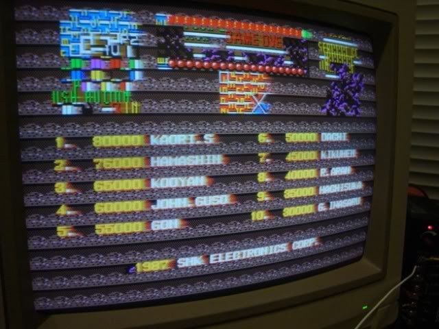

    This board popped up on Ebay a while ago, I was outbid and kinda regretted it afterwards, so when it was relisted for some unknown reason I paid it a bit more attention. Did I outbid anyone on here?
    Short Version - board would not boot, single image of crap resetting on screen, constant coinup noises.
    Bad 74LS157 at 8A on middle board.
    Bad 74LS157 at 8J on middle board.
    Bad 74LS245 at 6B on middle board.
    Bad 72LS32 at 2G on top board.
    Bad 74LS153 at 1A on top board.
    Long Womble Version

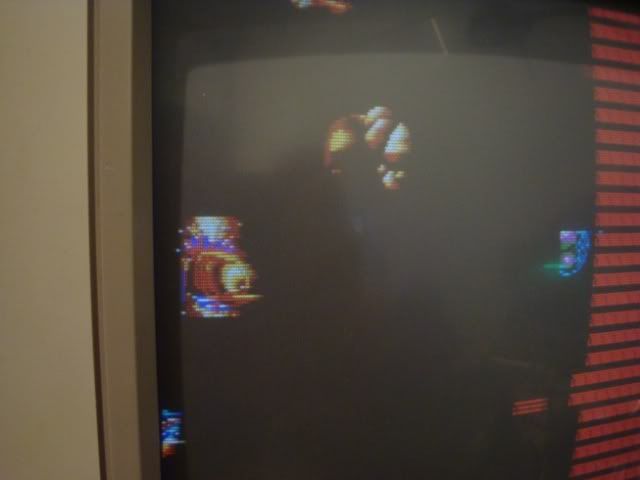

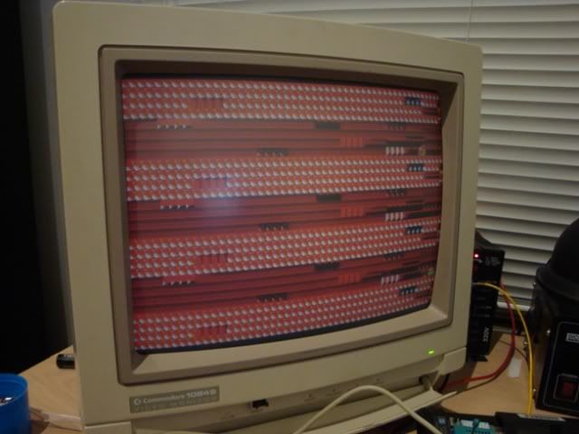

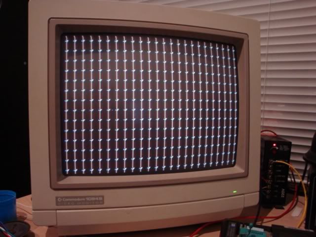

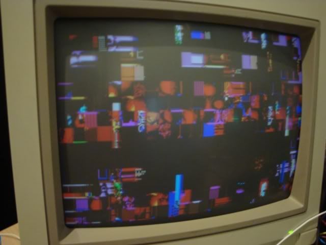

    The board was listed as faulty, the seller saying it displays coloured blocks on the screen, well it didn’t. It displayed this screen with constant resets.
    The screen was actually flashing white between resets, and it was so rapid that it gave the image a torn up jagged look as it was rescanned on the screen.
    The clean image above is more to do with a fast camera than anything else. There was also an loud clicking from the speaker and the coinup sound playing every time the screen reset.

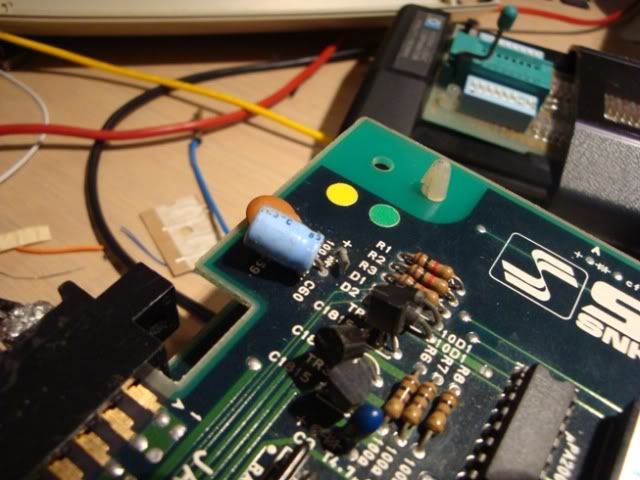

    PCB board stacks are a pain to work with, but at least the PCB underside is well protected being inside the stack, usually both boards chip sides are on the external edge, anything over 2 boards and it gets very hard to work on the board as you have somehow unhinge the boards while still keeping everything connected if you are to get to the middle one while it’s all running.
    Anyway - at first glance the board was in very good nick, no visible damage or even chip surface scratching, there must be over 400 logic ICs on this board and all but about 6 are "F" branded, never a good sign, although they are often faulty in an obvious way which can help. There was one damaged electrolytic that I removed and replaced.

    I went back to the Z80s on board 1, Z80 #1 and #2 were socketed, so I swapped in known good Z80As but that didn’t change anything, I removed Z80B to try and work out which RAM chips were associated with Z80A, but with the resetting there was still activity on all the RAM chips address lines so it didn’t really help. A missing CPU also causes a lot of chips to have floating inputs and this can look like a fault on its own.
    There is no RAM on the top board, and only a few 6116's on the bottom board, Sod's Law seemed to be in play meaning the fault was going to be on the least accessible of the 3 boards. The trouble was that although 5V and ground is carried on the ribbon cables, it is also on fairly chunky looking link cables from board 1 to 2 and from 2 to 3 at the opposite end, conveniently the manufacturers used black wire for the 5V and red for the ground – the lead plugs are keyed and cannot be reversed, if I hadn’t checked the polarity my logic probe would have been destroyed. These link leads are presumably to take the current load off the thin wires in the ribbon cables. So I made a meter long link cable so I could hinge board one out of the way keeping the ribbons to board 2 connected and still power the lower boards from the top board. The only place I had enough room to do this was on the floor with the JAMMA connector connecting to one of my cabs, not ideal!

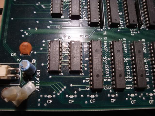

    Started to sniff round the board and almost instantly found some smoking guns, clustered around 4 6116 RAM chips are 6 LS157s, the 157 at 8A had all 4 output pins floating and the 157 at 8J was missing 3 of its 4 outputs.
    Piggy backing new 157s lit up these missing lines but did not fix the resetting issue, the sound effects did cease. In fact while probing around the area I did disturb the piggy backed 157 at 8A and the board started to sing to me! The sound track on this game is made up of about 10 samples of vocals. Clearly the crap on the line had made enough sense to the sound system that it was interpretted as a trigger to play one of the samples. Freaky, but it did prove that the sound system was working correctly. By removing and replacing the piggy backed 157s I got a variety of sound effects to play, including samples and the chip tune backing. So I soldered the 157s in place and the board became silent, still constantly resetting but no more cacophony of coinups.
    I moved on to the RAM on this board, the system was going to be trying to test CPU#1s RAM and that had to be somewhere, the small amount of RAM on board 3 looked healthy if a bit unused. Hitting the address lines on all 4 chips with the logic probe showed a lot of activity on most chips but problems with the two 6116 chips at 8C and 8D. Both had address lines stuck.
    8C had A6,A7,A8,A9,A10 tied low and 8D had much the same with one line stuck high. The other 2 6116s looked ok. Always suspecting the RAM I desoldered the two chips and put them through my eprom burners test program - both chips passed with flying colours.
    While the chips were off the board I went round the empty pads with the probe and traced the stuck lines back to an LS273 at C5, it had an active clock and looked fine apart from the stuck outputs, so I desoldered it and tested it - it too was fine. With this chip off the board I went further and found an LS245 at B6, this looked fine too except for the stuck lines, so I pulled it off the board and tested it - it failed miserably. With the 245, the 273 and the RAM off the board all the address lines were floating. Clearly it was just the 245 that was jamming the addressing system for those two chips.

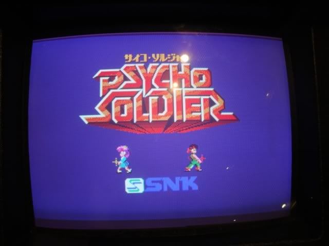

    So I fitted a new 245, also a new 273, and resoldered the RAM back in place. Plugged it into my cab and powered up. The game went through its tests, passed all RAM and ROMs and the game started.

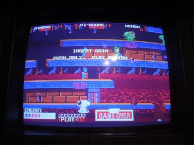

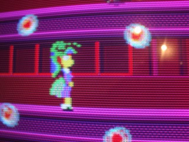

    Initially everything looked good, the graphics were clean, no glitches, the sound effects, music and samples were playing, but the colours looked pretty strange. It also struck me that there were no enemy noises, ie no "hit" noises. I soon stumbled across an LS32 at G2 on the top board with a stuck output pin (held high). This line cuts straight across the board on a track about 15cm straight into the unmarked custom chip near the sound section, seemed a good candidate for the fault, and replacing it lit that line back up and all sounds were restored.

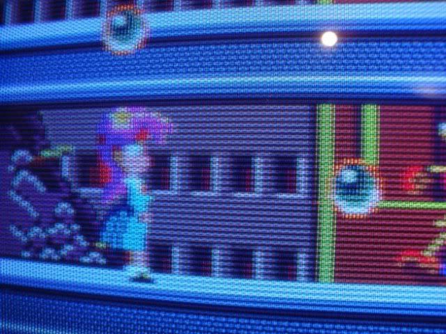

    The main chr sprite still looked very odd tho, green hair?!? The star in her hair should be yellow, not green with a black trail!
    so I fired up MAME to compare, and noticed a couple of things were wrong.
    Firstly the stone background on the title screen was missing
    also the sprites were all coloured slightly wrongly and the back-drops looked odd too. The screen after the game splash screen with the two characters faces is coloured wrongly, the faces are purple not pink and it too is missing the stone backdrop effect.

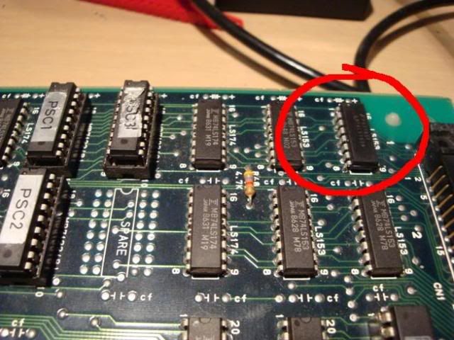

    On the main board there are 3 colour PROMs, so I went around the board area near them and quickly found an LS153 at A1 that had missing outputs,
    ..so I replaced it and rebooted
    the sprites and the backgrounds were now perfect, but other faults remained, animated backgrounds are not coloured correctly and powerup gfx element the same.
    I set the game into test mode and the 1st test is the colour swatch test, clearly something wrong here, the green is ok, the white is ok, the blue is very pale and the red swatch is pale green.
    I am not sure where it is generating that test, as it would suggest the board can't do red, and that all the blue should be weak, but in the game the colours are bright and all are present. Clearly something is not quite right, it might be the colour PROMs themselves but I doubt it.
    Probing around the are same section as the duff 153 I found I could alter the colours by injecting crap into the 153 inputs, also triggering the "clear" on the Ls74s I could bring up the stone effect patterning, it was all bright red but it suggests the data is there, on another pin the grey stone appears but the rest of the screen is garbled. This is what happens when I short data on one of the 153 pins...
    Replaced a few more 153s and the 174s in that area but it didn't change anything, my logic analyser shows the chips that are there are working ok but I may replace them anyway.
    And that is where it is at at the moment, all in all its taken me about 10 hours so far, sounds a long time when reading the above, but hindsight is always twenty twenty, a schematic would have been very helpful, as tracing lines across multiple boards is very time consuming and frustrating work. At least the board is now working, my concerns about the unmarked custom were thankfully unfounded, still a bit more work to do on this, it probably is just a single fault that is left, but faults like this are the hardest to find. A board that is doing nothing gives you clues, a board that is doing 99% the right thing is much harder to work with, especially without a schematic, may be a week or two before I can get back to it tho.

                          Fired it up again this morning to have a go at finding the last fault, only to have it die before my eyes. It booted, got half way through the intro and locked up.
                          Powered it off and now it passes CPU A RAM and ROM, then goes to a blue screen with crap at the bottom.
